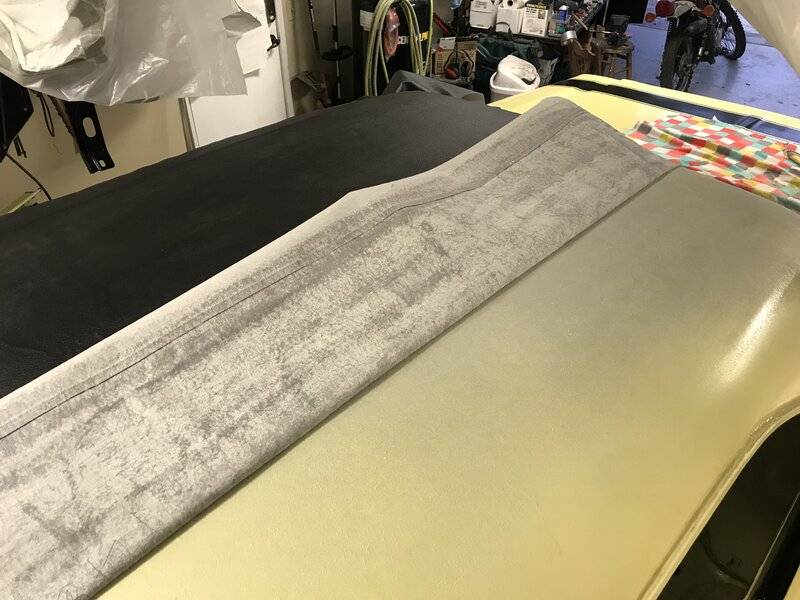

I took a big leap of faith tonight and decided to put on the vinyl top. Definitely a huge learning curve. I had everything measured out so it was centered. What I did wrong the first time was starting from the center out towards the passenger side about 10 inches I applied spray glue to the top of the roof and on the bottom side of the vinyl. Then I tried to stand on the opposite side of the car and use my fingers to slowly push the top slowly towards the passenger side. That didn’t work so well. Lots of creases. I pulled it back up and got things reset. Then I pulled towards myself from the same side of the car, passenger side, I used my fingertips to slowly Roll the vinyl down moving front to back putting down about a quarter inch or so at a time. That worked excellent. Heat gun came in handy around the rain gutters and around the rear sail panel area. It’s not perfect but I did it.

Possibly The difference here is that you can’t set the vinyl down on top of the roof skin and moving around. Once it’s down it’s down. It’s a process of getting it down as good as you can and then going back and working on flattening everything out. Of course you don’t want creases or big wrinkles but there are small bubbles that pop up and you just push back down

That may work. I think it would need to be a pretty long and somewhat flexible squeegee to make the ark of the roof. What I found when I was trying to push from behind was that because the vinyl is so thick enlarge it didn’t really follow itself. One side would move one side would stay and get kinked. Working it from the front side I was able to evenly pull the top down. Basically working it from the front instead of the back

I had the top laid out on the car for the last month or so. When I first opened it up there were a lot of folds from being boxed up. Every now and then I rolled it into the sun to help it flatten out. When I actually glued it down last night pretty much all of the fold marks were gone. I was able to get most of the small bumps and stuff out of it when putting it on last night. The one thing I did realize is that the amount of glue you use makes a difference. Somewhere I read or heard if you think you have enough glue down put more down. I found that when there was too much glue it had a hard time sticking down even after letting it tack up. I did a couple light even coats for the rest of it and it went down and stuck down better.
Also, initially I only bought two cans of the 3M high strength 90. Definitely get three cans.

Possibly. For me I like to use my hands so I can feel the material and feel how it is laying down. I found it easiest to just continually go front to back slowly pulling the top. I did the passenger side first which is where I was trying the other technique. That side is down but the driver side using the pulling forward technique is perfect.

Helpful hint. After the 3rd one I learned a trick. I now use the wife’s clothes steamer to heat and soften the material to stretch it and lay it down smooth.

Another useful tool for the vinyl install. Stop by a neighborhood Sherwin Williams or any Commercial paint supplier and pick up a "smoothie". A white-ish plastic smoother for installing commercial wallcovering (roughly about 6" wide). I've used em for vinyl tops, tolex covers for vintage amps and of course vinyl wallcovering.
A heat gun and or a propane torch with the push button igniter (my personal choice) is helpful for tucking into tight corners (drip rails, ect)
