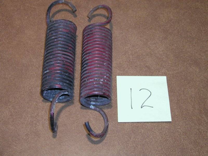

Agree with # of coils, except I call it 22 total (I just counted them) with the 1/2 coil on each end with the hooks.
I guess the other aspect of this is, you didn't tell us what year his car is. Both of mine are '69's. Its possible that a '70 or later could have different springs.
A photo of factory '69 N96 spring........
Hi, 69 is in the title. Thank you for the pic. I will forward to him. Thank you. Mike

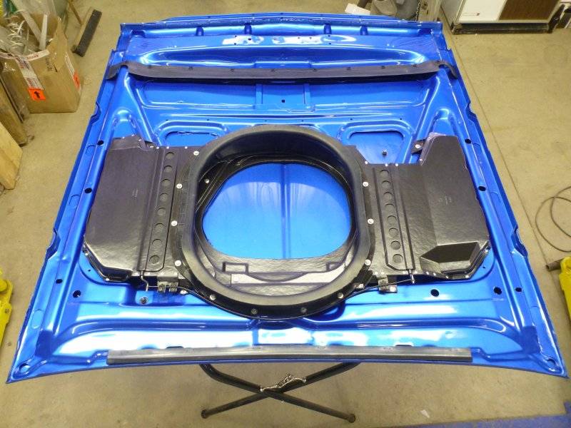

Ok I can see on longer hoods like 71/72 Charger with Ramcharger N96 On my non factory N96 car it’s being holding up (no pun intended lol) but that set up is limited to only 1 piece for the box unlike the 3 piece units found on other cars like 69 Plymouth and 68/70 Dodges. Just my experience but shouldn’t the parts books have 2 different numbers for with and without N96. Hopefully someone will post a pic of the parts manual on this model or others. Just my 2 cents
Those 2 fiberglass scoops added how much weight to the steel hood?
5 pounds.....maybe?
