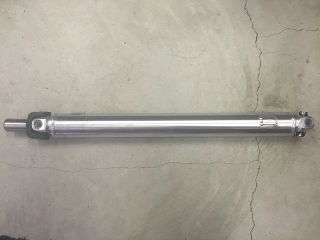

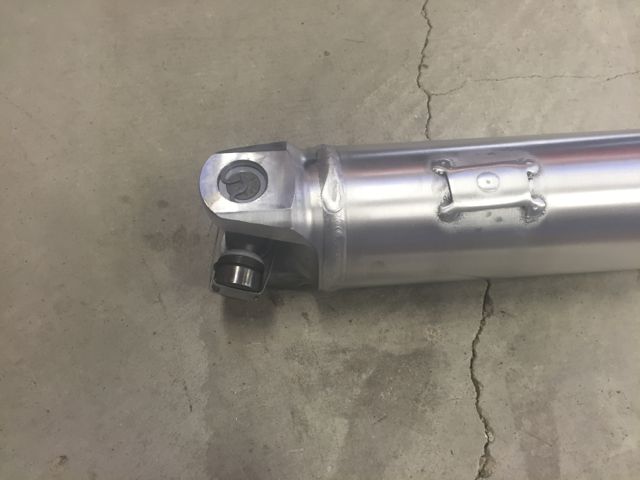

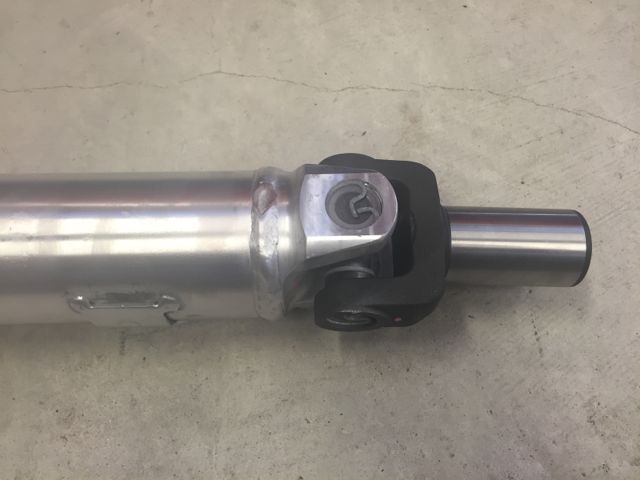

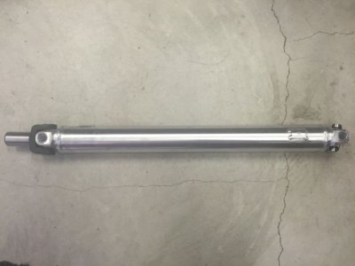

Dyno-tech in Michigan, free shipping, great quality. Their steel shaft will be more than enough. I own 3 of them, two steel, one aluminum. The aluminum one holds up behind my 572 64 Belvedere, 1.25, 9.04 @
