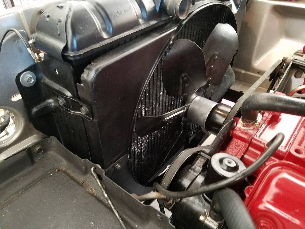

Since installing the 7-blade fan I got off eBay and shroud I bought from a forum member I bead blasted and painted, and then using a toothpick for an hour opening some bent fins; it has made a big difference with cooling. I also removed the stat since I have heater bypassed and have electric choke/headers anyway. Using laser temp before/after, it's been running some 20-degrees cooler than it was. I've been running mostly water so far after some flush additive having flushed the system three times now before I'll put in a 50/50 anti-freeze mix. This is to really clean out that stop-leak **** that engine shop tossed in. So far so good. As I understand this is the exact factory setup with A/C equipped car that year (63). I can't say what will happen if it's 100 degrees out as we seldom see these temps in WI; but reckon we still have some hot weather before the snow flies here for me to find out..
Please keep us posted as to what happens when you go to 50/50. The theory and data I have seen I would predict the temperature will increase by about 10 degrees F by going from pure water with additives to the 50/50 mix. It is hard to get 2 days to be the same for a good comparison though.
