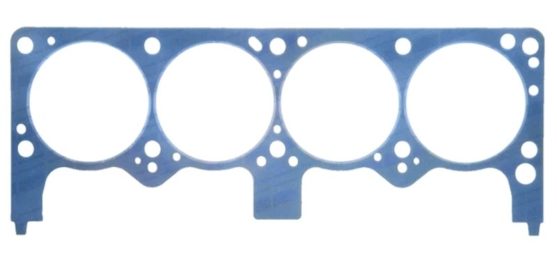

Mine is a SB. 318 Thermostat is/was new but was a cheap brand. Maybe I should change that to a Stant.. Are the Head gaskets reversible on the Small blocks? I think I looked at them and FIRC they looked the same on both halfs of a gasket. I think I have the old gaskets I'll look

318 gaskets aren't reversible. Here is a image of a felpro.
