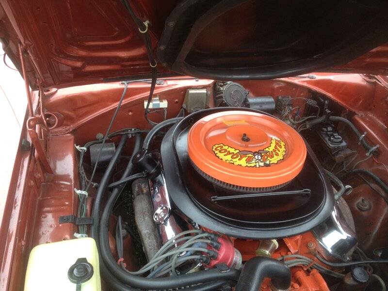

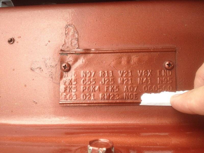

This may not apply to your car, but a number of early 70 Air Grabber cars did not have the hole and the grommet. The wires came out just behind the voltage regulator. These may have been more prevalent on California cars, but that is speculation on my part. My 70 Air Grabber is like this, so I don't need or use the grommet.
Obviously, if your car has the hole drilled for it then you need the grommet, but I just figured I would provide the information to you and other members just in case. Below are a couple of pictures of a verified original N96 car without the hole drilled FYI.

Much Thanks Hawk,
I had forgotten that yours didn’t have the hole. Mine does. Unfortunately a prior owner removed all the AG stuff. So I’m piecing it back.
I think I’m just missing the hoses, clip for the switch to hold molded hose thing on, solenoid, then some gaskets, and new seal. Then will have to refurbish my hood and hardware. Hopefully the actuator still works.
Oh and the dash molding and bezel. Need that but have a wanted ad for it.

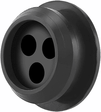

I stumbled across a grommet that might work for anyone not looking for 100% originality but still needing the firewall to be sealed. I've found a three hole grommet that will fit a 3/4" hole, although the three holes themselves are 5mm and might require a bit of reaming with a drill. I haven't gone out to my car to see how close of a fit the hoses are.
Kiwigtx original picture:
Replacement grommet:
Sorry for the dusty picture, that's what happens when you zoom in.
Anyway, these are cheap replacement parts sold as fuel tank grommets for small gas engines. It cost me $8 but there were five of them in the pack. The listing says the size is 1" but that's the larger outside diameter, the inner part that fits the hole is 3/4".
www.amazon.ca/dp/B07X9MCYC8?psc=1&ref=ppx_yo2ov_dt_b_product_details
