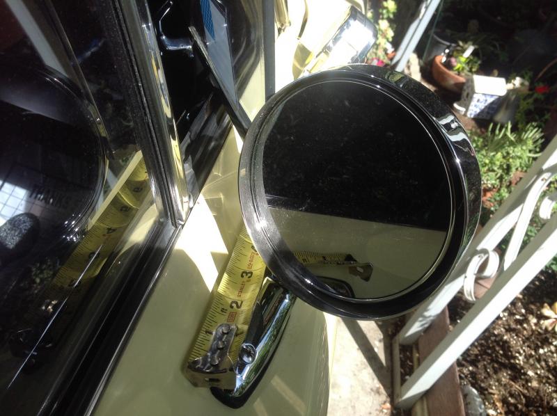

Customer wants a passenger mirror installed and I already have a new one, just need to know where to put it.
Sorry for delay. I was traveling on business. I can get this done tomorrow AM.
19.5" on both sides. Edge of door to base of mirror.

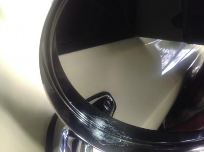

image.jpgimage.jpg NOT factory. I drilled through to a factory welded nut inside the door and this is the result. Talk the customer out of it. It pitted up in a few years too.
If your wing is hitting like that...it's NOT right.
19.5 was the ticket, it fits perfect and matches the other side and the vent window doesn't hit it.
First picture is the drivers side mirror installed on Lynch Road on May 26, 1969. The second is the recently replaced passenger side mirror. Already starting to pit. Junk.

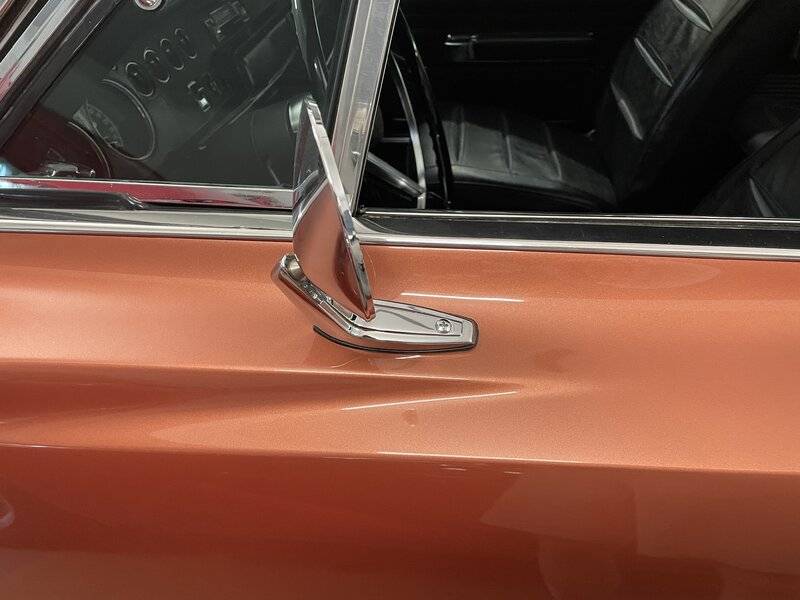

I know this is an old thread, but related question.
Is a passenger side mirror that matches the driverside (factory installed) mirror, correct for this car?
I have two 68 Chargers; one with dual manual mirrors and one with the LH remote mirror and a matching RH mirror and the passenger mirror is in the same location as the LH mirror.
