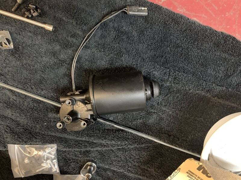

How exactly does this work? When you turn on headlights it will open the doors, but how does it know to stop? When you turn off lights how does it get the signal?
There is a headlight door relay under the dash, below the instrument cluster. It gets inputs from the headlight switch and dimmer switch. The motor itself has internal stops that are set by the factory.

No problem….yet. This is a custom build. I bought the car with boxes of parts, Uhhggg. I’ve done many Mopars, just not one with these doors. I can set up my own relay, no big deal there. If it is set to the factory, does it need to be clocked?
How do the doors close, is there something in the switch?

I have one that works, I’m asking about how they work. There is two positive ports. One up one down (I guess), my question is how does the signal go to the motor. Is it in the switch?
