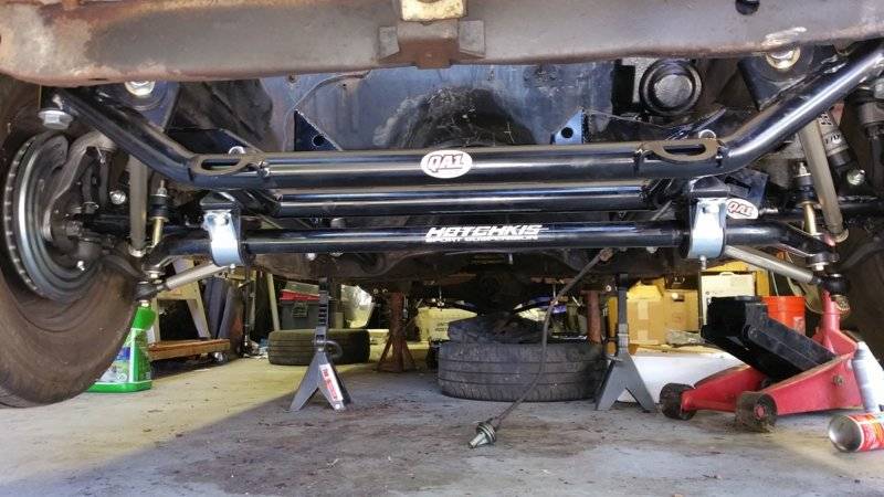

I am in the process of building my car.. I went with the QA-1 subframe and love it except... I run the Milodon Road Race Oil Pan with external pickup for my 540 and the pan comes too close to the engine mount towers and the hose from the pan to pump has to be modified.. Milodon has since changed the hose and pump pick-up..
Awesome news! Have you heard if anyone is running the factory spindles or any aftermarket ones? I am basically working with a bare body
I am running the QA-1 lower arms, stock spindles (Well stock re-pops from a disk brake conversion) and Hotchkis uppers.. The QA-1 accepts all stock parts.

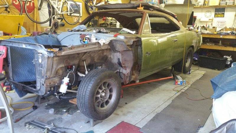

Here you go.

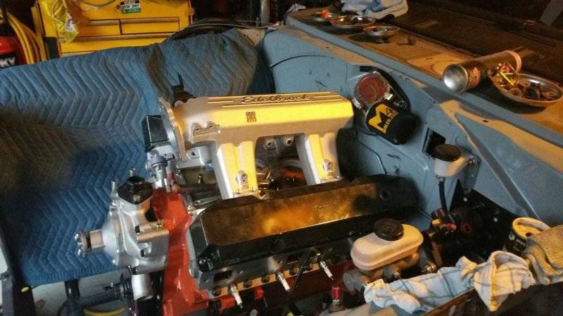

Car looks good I’m almost done with metal work. Motor is done.
No metal work, just want vroom-vroom noises for now!

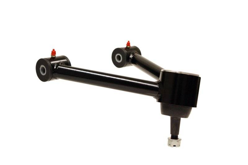

QA1 UCA's (formerly Capps Automotive/design) adj. poly bushed
QA1 Mopar {Capps Automotive} Mopar B-body Adjustable Capps-QA1 Upper Control Arms.jpg

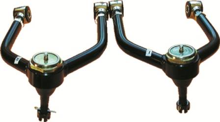

SPC UCA's dbl adj. on car
with more caster angle built into the ball joints location
