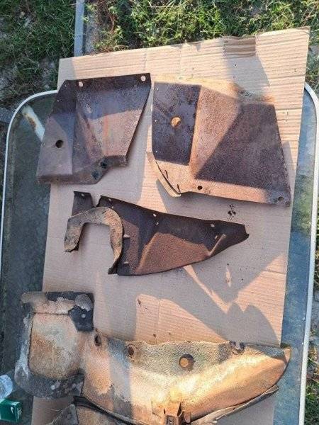

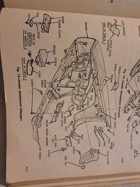

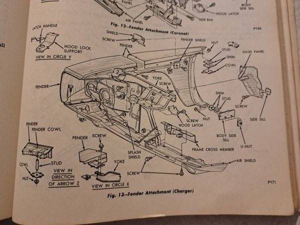

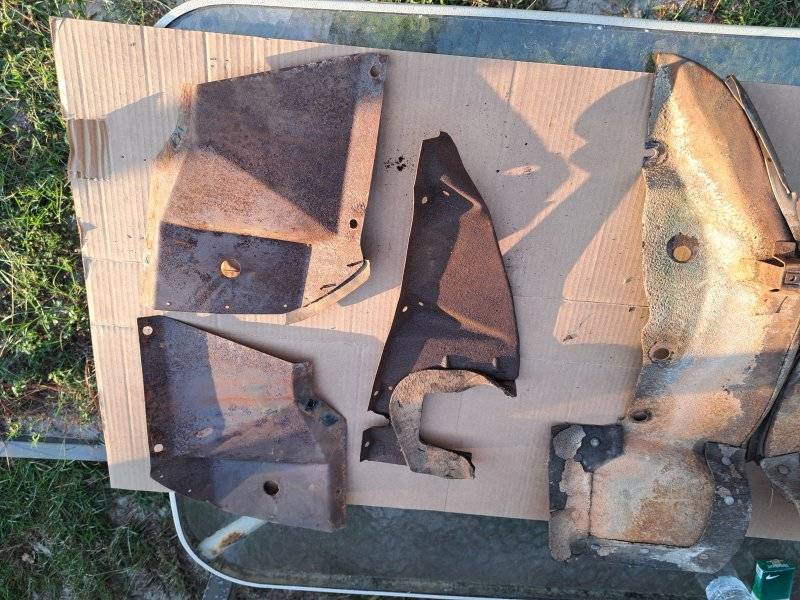

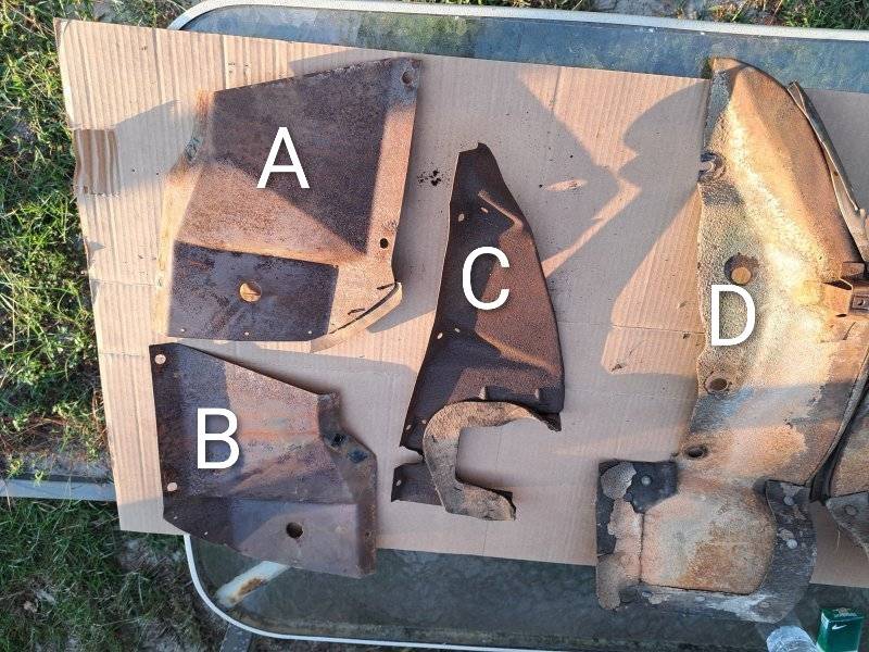

I could use a couple pics of how it bolts to the front of the fender,not next to the doors. Yes I have the shop manual and just dont see it. Thanks for any help. Dave Sorry about pic @DeltaV / @kiwigtx can you fix my picture?

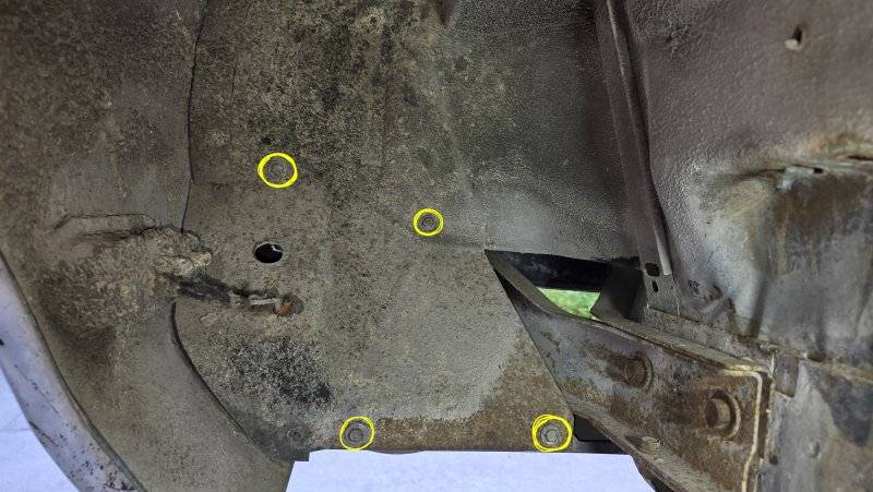

Left front wheel well. Looking forward.
Four (4) attaching bolts circled in YELLOW:
Five (5) push clips through the rubber seal and splash shield circled in RED.
Note: There is an upper rubber seal too and its lower edge slightly overlaps the rubber seal and upper push clip for the splash shield.
The upper rubber seal is outlined in BLUE:
Closeup of upper seal overlapping the lower one.
Right front wheel well. Looking forward.
My splash shields and seals have already been removed.

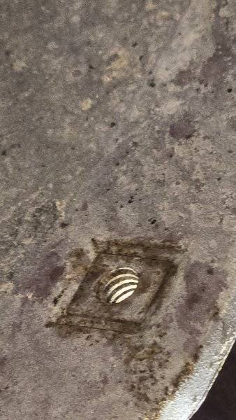

Two speed nuts (whatever they're called) are visible for splash shield attachment to the valance panel. The upper two holes have a square-bodied nut, either pushed in or welded to the sheet metal.
Each upper hole has this type of "nut".
Close-up of upper nut taken from inside of wheel well:
The upper rubber seal I showed for the left wheel well (prior post) is covered with undercoating. Below is a picture of the right wheel well without the upper rubber seal installed. There are eight (8) holes for mounting the upper seal.
