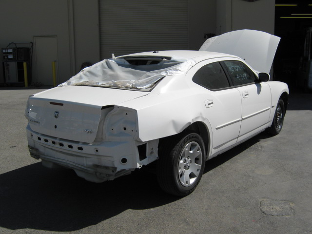

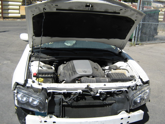

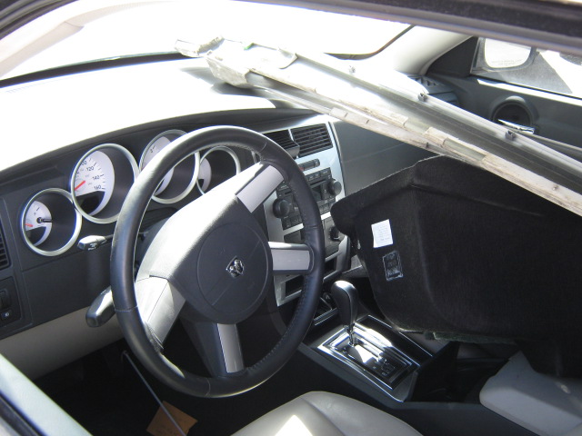

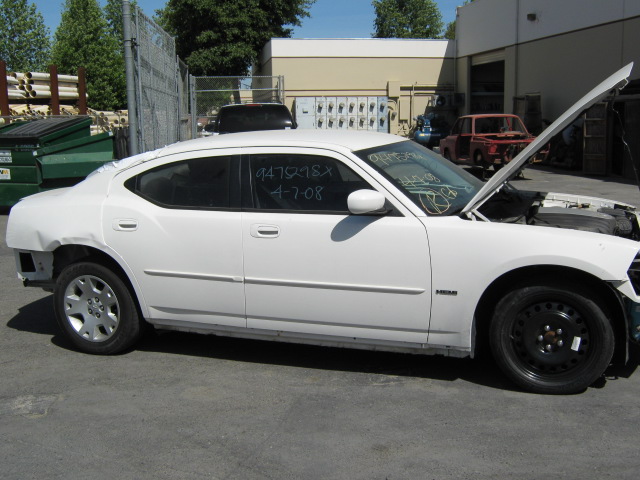

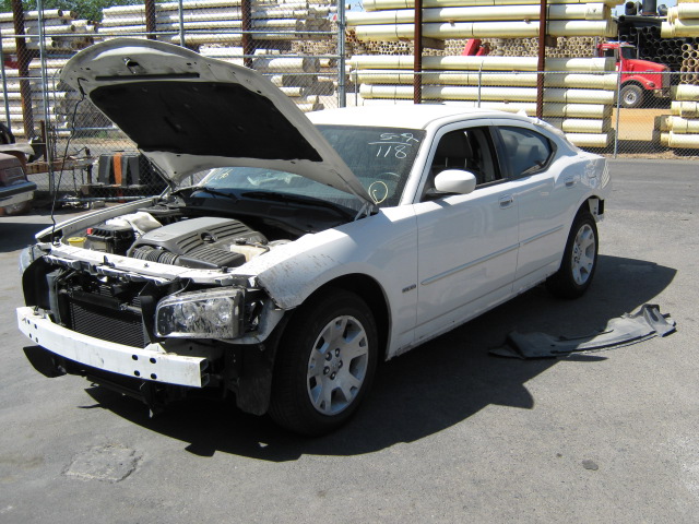

I am way deep in swapping everything I can from a wrecked 07 Charger R/T into a 70 GTX.
5.7 ,w5a580 transmission,all computers,seats,disc brakes(no anti-lock) hell,the donor car even has a satellite radio.
I got the donor car from Copart, an on line auction firm that primarily sells insurance totalled vehicles. I paid about a 1000 less for the entire car than I could buy a crate 5.7 for!
I will be able to part out the R/T when I am done with it, lots of body parts good not to mention two undeployed air bags.
Here are a few pics to date. I will keep this thread updated as I make progress.
This is the donor car

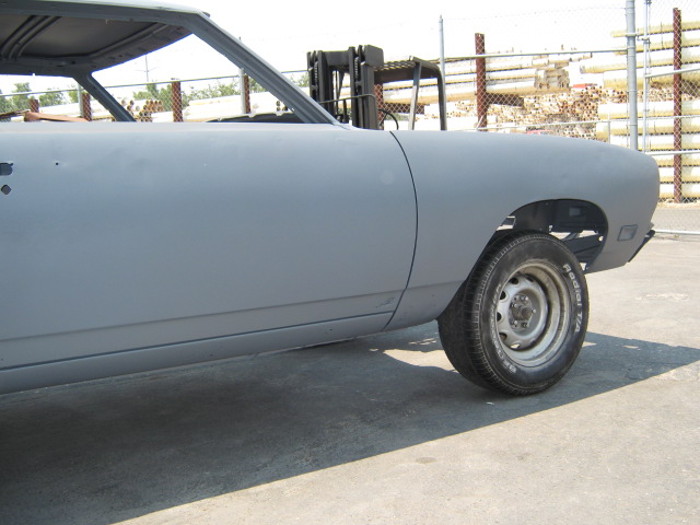

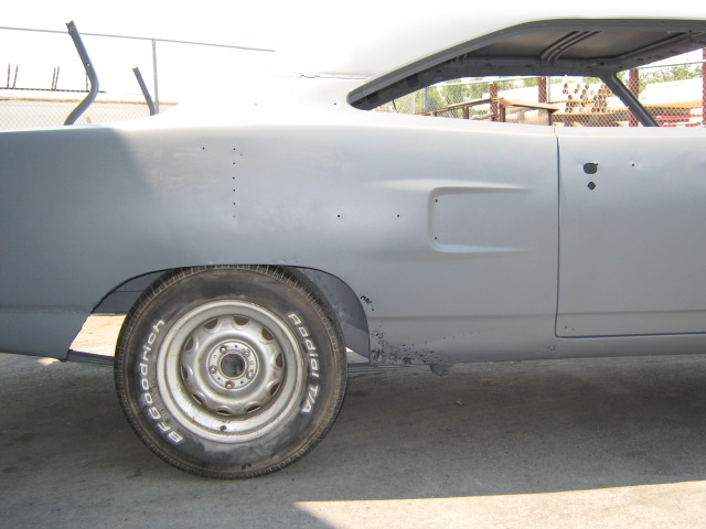

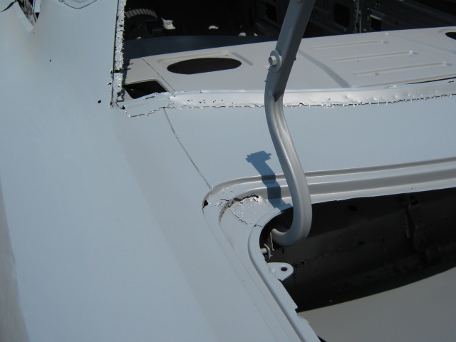

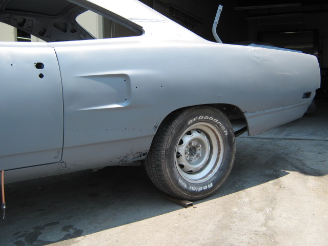

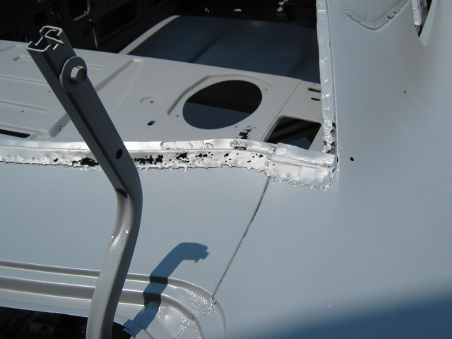

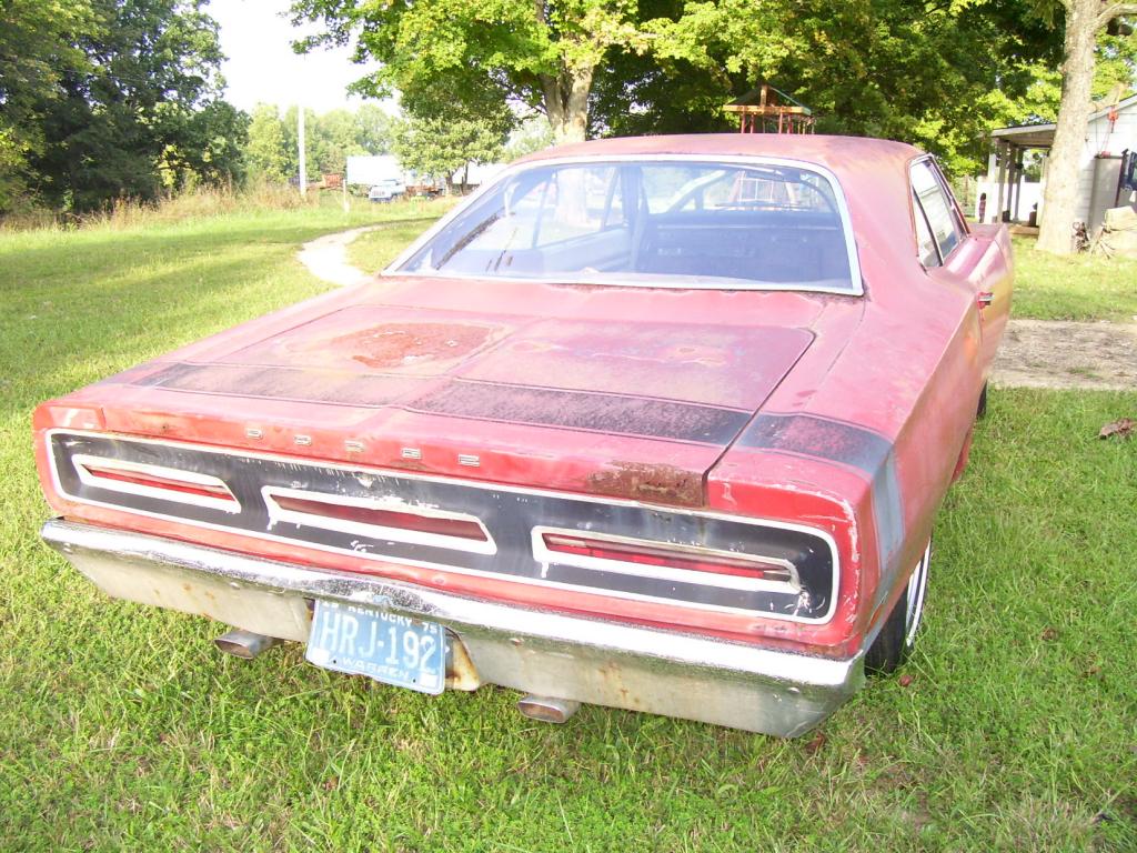

Here is the chunk of Swiss Cheese on wheels I got back from the paint stripper

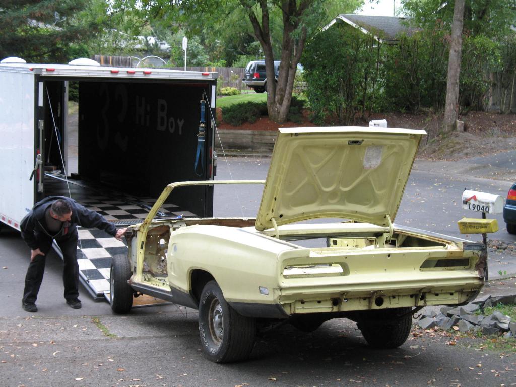

Have fun with your swap man... I am doing a similar swap currently into my 68 Charger.... except I am using a 6.1L Hemi with a 5-speed manual.
The Hemi
Torque Boxes
The Charger - yes it used to be White
Disassembling
If you have any questions I have done much research on the topic so feel free to ask and i'll help any way I can

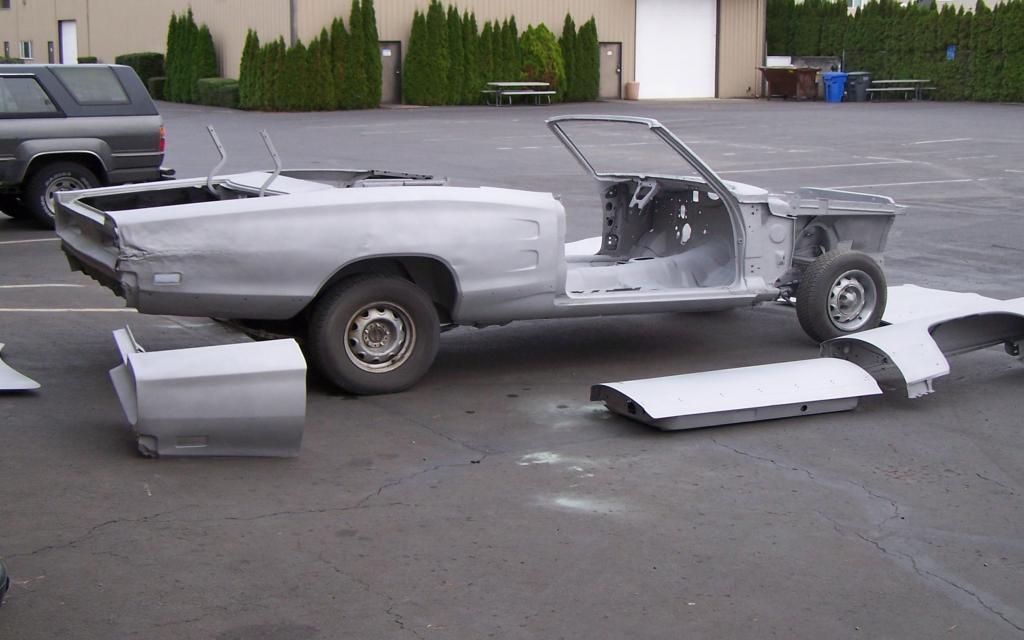

I got the car back from the stripper and I pretty much need to replace EVERY panel and the front frame rails as well as 3 of the 4 door posts.
The search is on for the parst and I have located many but still need hood,trunk,1/4s and fenders.

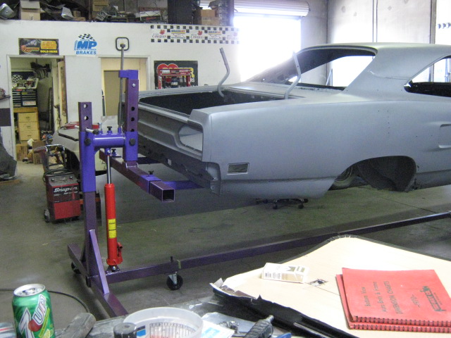

I have the cowl removed (rusted out window lip) and basically just drilling spot welds and waiting on parts for now.
This will obviously set me back and cost way more than I wanted but that is name of this game I suppose.
At least I get to work on it consistently. Pretty much every Thurs and FRi all day and any other weekday I can leave my business in the hands of my employees.
I'm in for the long haul so I am trying to be patient!
