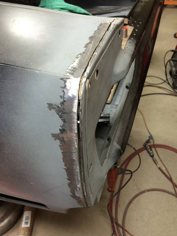

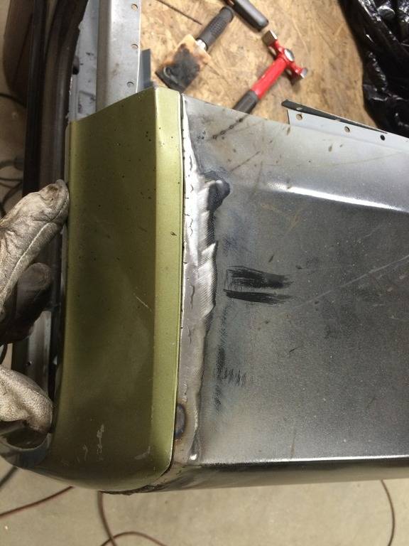

If any of you have read my budget build 440 thread, you know that not much has happened to this. I finished the 440 and I've got a 408 build going as well. I'll dyno that and post on it when done. What has happened is that DonC emailed and the rear window plug is done and ready to ship. I'll have it in a week or so. I have been waiting on parts for the 408 so I took a night to do a little work on the Superbird. The rear quarter extension were on but didn't fit quite right. It seams that the rear of the quarters are different than my other roadrunner that has it's original sheet metal. The extensions angled when tightened rather than set straight so that they form a straight line across the trunk lid. Here's a few shots of the driver's side which is the worst and the passenger side, which was closer. I welded the passenger side up but I'm going to slice the quarter panel to fix the driver's side and weld up the gap with a sliver patch in it. What a giant PAIN!

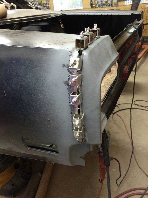

I don't see how that could have happened from my installation of the quarter panel, but who knows. Anyway, for the rear of the car to look right it has to be fixed. You can see what I did here on the passenger side.
The top portion is almost done and it won't look too bad but will need some filler.

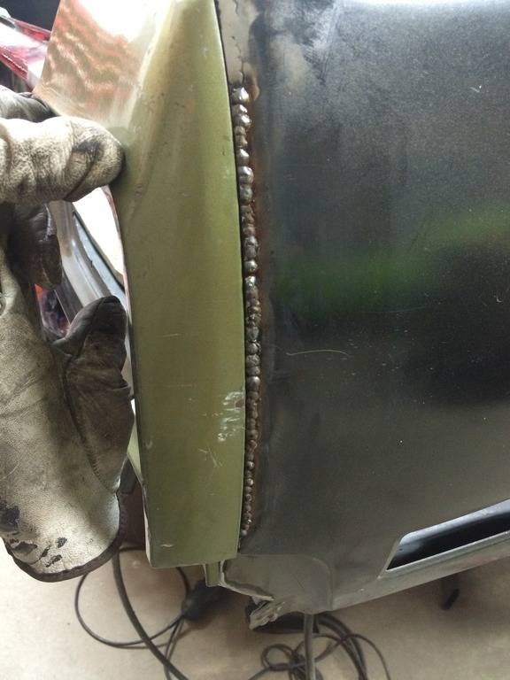

The side is under way and won't take too much more to finish up
Those little slivers are the most tedious kinds of repairs. I had to do quite a bit of that to get my door and fender seams reasonably straight but I was repairing the old metal. Kind of disappointing to have to do this kind of thing to make new parts fit cleanly. Looks like it is coming out right though. Nice work.
