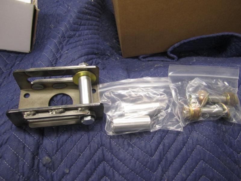

You said you were using Caltrac springs,I saw the Afcco sliders also. To use those sliders on Caltracs you will need the slider/bushing kit from Afco,or better yet,return the Afcos and buy the caltrac slider. Caltracs come with the bushings to fit a Caltrac spring,caltracs are slightly different.
Been there and it held me up for 2 days!Don't forget to box those stock perches,at your power level the stock ones need all the help they can get.:blob1:

Welcome HEMI-itis, I'm using the CalTrac perches which are boxed. The slider bushings will only take an hour on the lathe to turn new ones. I always have stock on hand for those kinds of projects.

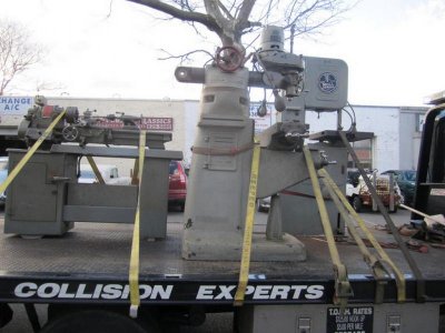

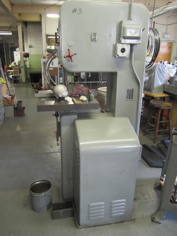

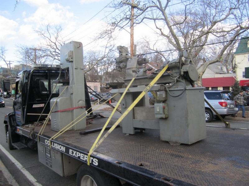

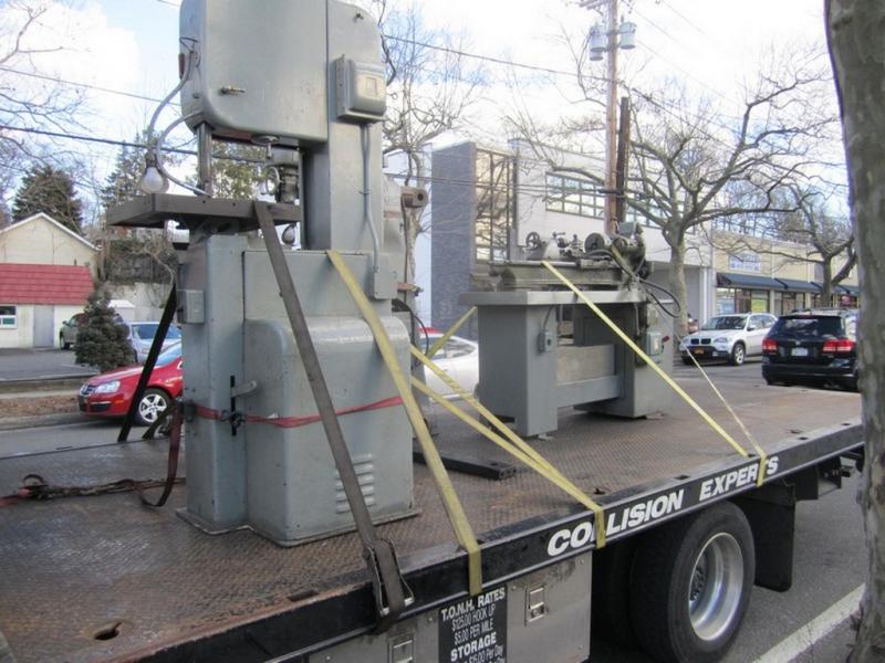

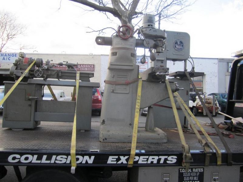

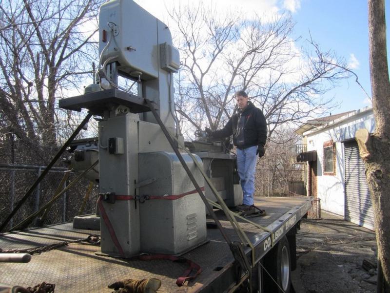

Had most of the equipment that I picked up,,,,,,just had to bring it to an other than my shop,,,,,,,,,,
Bridgeport,lathe,bandsaw,,,,,all,,,,,,NOT MINE!

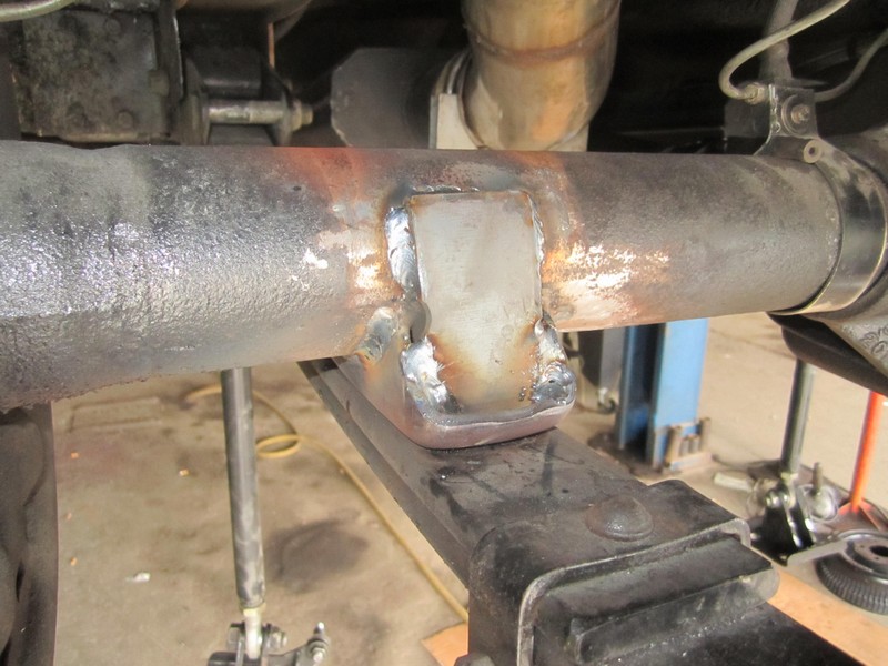

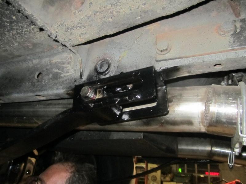

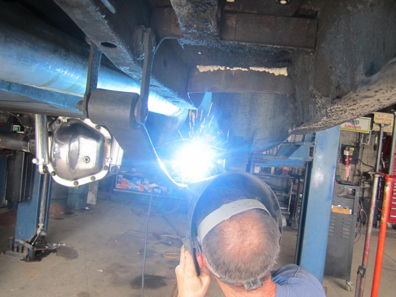

Not feeling much better, but going nuts in the house. Modified some of the stainless line clips to better hug the axle tubes by drawing them down against a slightly smaller tube to allow for springback.
The ends are tube nuts and tube sleeves put on and then the end of the tube is flared. The rigid brand 37 degree flaring tool is amazing to use. Perfect flare every time.
Had to put a little bump in the line so it wouldn't lay against the weld bead. You can see how nice the clamp lays against the tube.
This one goes into the main portion of the housing so it doesn't need to be curved. I was going to put two of them on this side, but didn't see the need after getting the other clamps on.
Here's the overall view of the line. I need to hit up Keepat to learn the best method for straightening coiled stainless tube.
