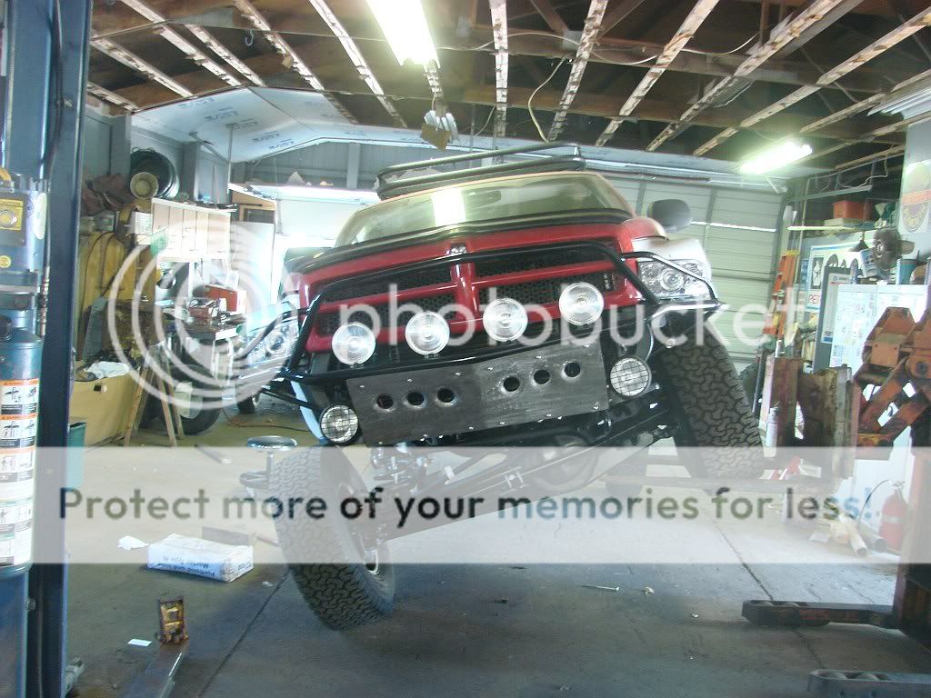

You are doing fine without it, but I'd recommend the Bend Tech software, if you run into any exceptionally difficult bends. I used it to make the front bumper for my truck with 9 bends on different planes on one tube and it came out perfect on the very first try. I couldn't even imagine doing it any other way.

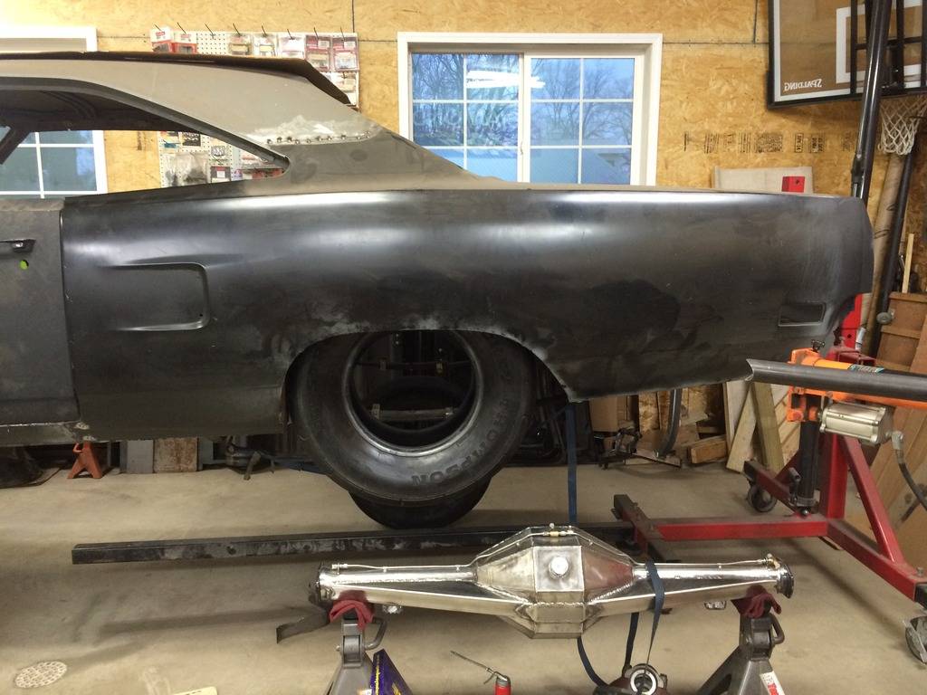

This is how the 30" radials will look. Would like it to sit lower, but I don't think it's going to happen. I should have raised the wheel tubs when I mini tubbed it.
That's what I found on my car. Wheelwell lip about 1" above the rim. Could go lower but want 3" of travel for potholes. Also you will have to shave the front of the wheel opening unless you plan on moving the axle back a bit. Allow 2" for tire growth!
I'm not sure I can live with this. I may have to do the surgery on the tubs.
Hey hemi, you got to be happy with what you want. Putting a ton of work into. You want it lower, make it lower...less drag too. Lol. It's gonna be badass.
Make it a no regrets build, and you'll be happy.

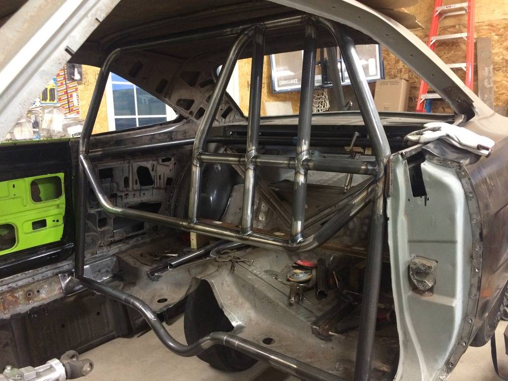

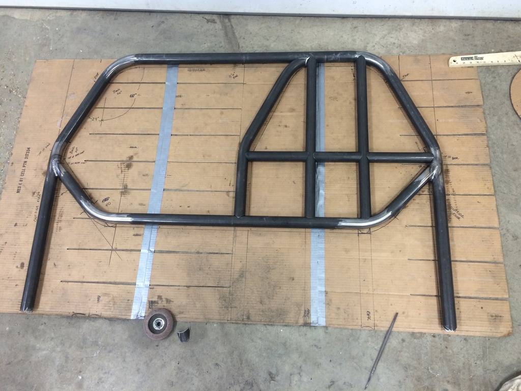

Got the main hoop assembly welded out. Need to fit the joint better where it meets the driver side of the rear hoop. The plan is to tack the two together in the car, remove it, weld it out and reinstall. You know the saying about the best laid plans though, lol.
Hemi, it is looking great again...but do you know the other saying...THE MORE BARS YOU HAVE TO PUT IN YOU ARE GOING TO BE FLYING IN THE QUARTER.

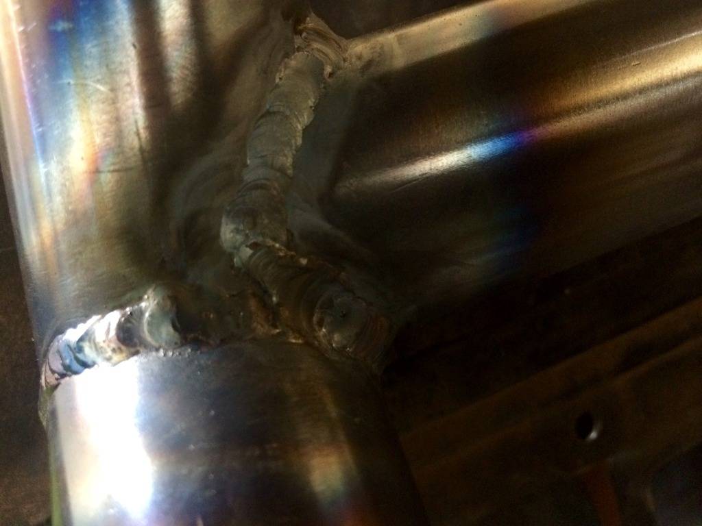

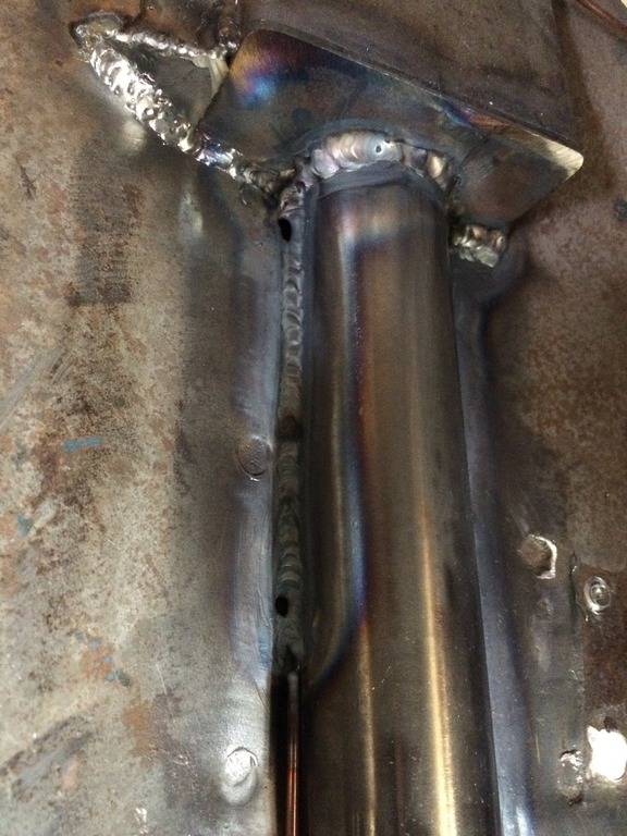

Welded the tubes into the floor that tie the #1 bar into the front spring hanger boxes. This bead is holding the torch in my left hand and welding .083 wall tube to the factory **** metal floor.
There's a couple holes to fill, but considering I'm right handed, I thought this went pretty well.

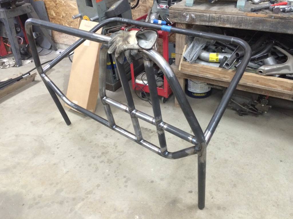

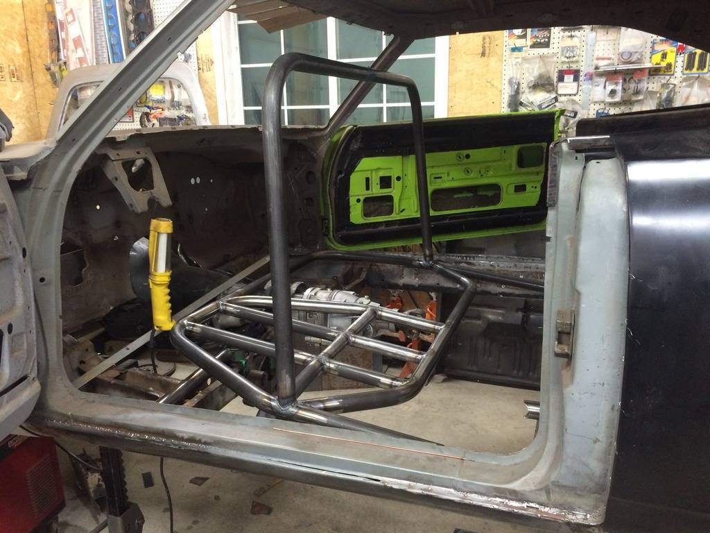

I put the main hoop back in and tacked the rear hoop to it. I removed it as an assembly, welded it out, and put it back in.
Here's how it comes in and out.

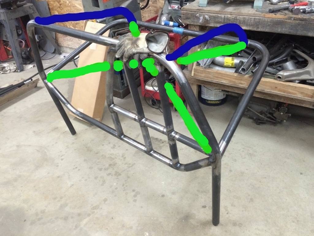

Here are a couple of additions. The tubes in blue are definitely getting added. The X- brace in green, I'm still on the fence with that.

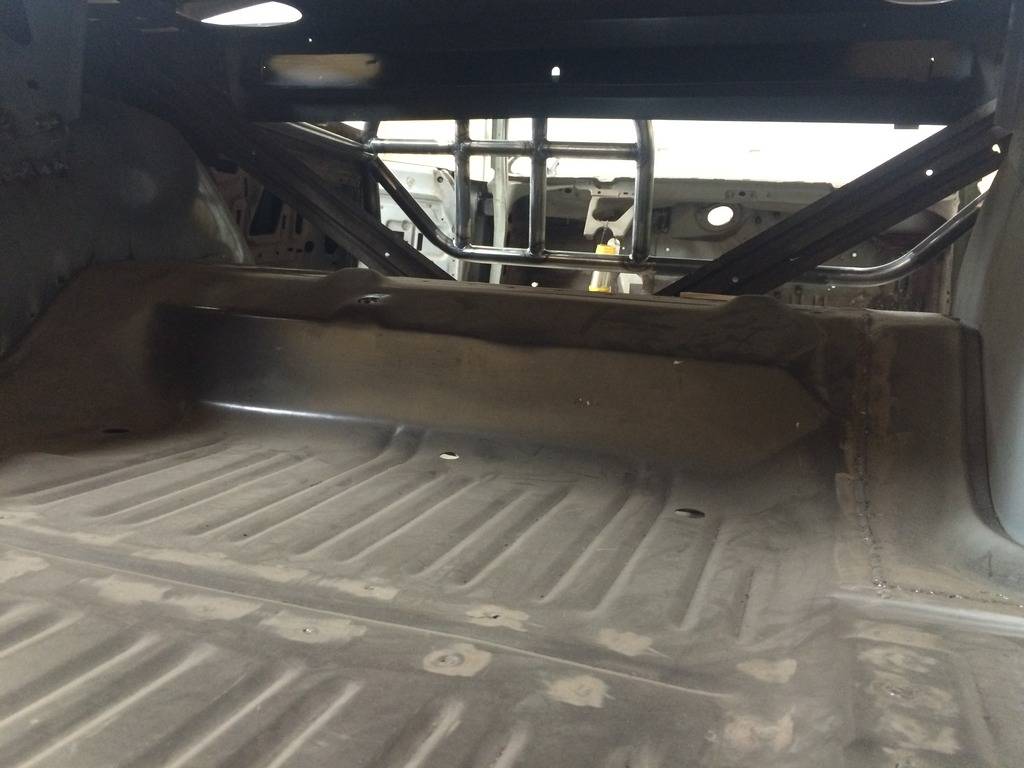

This is the view from the trunk. We're going to be adding a double frame rail setup in here.

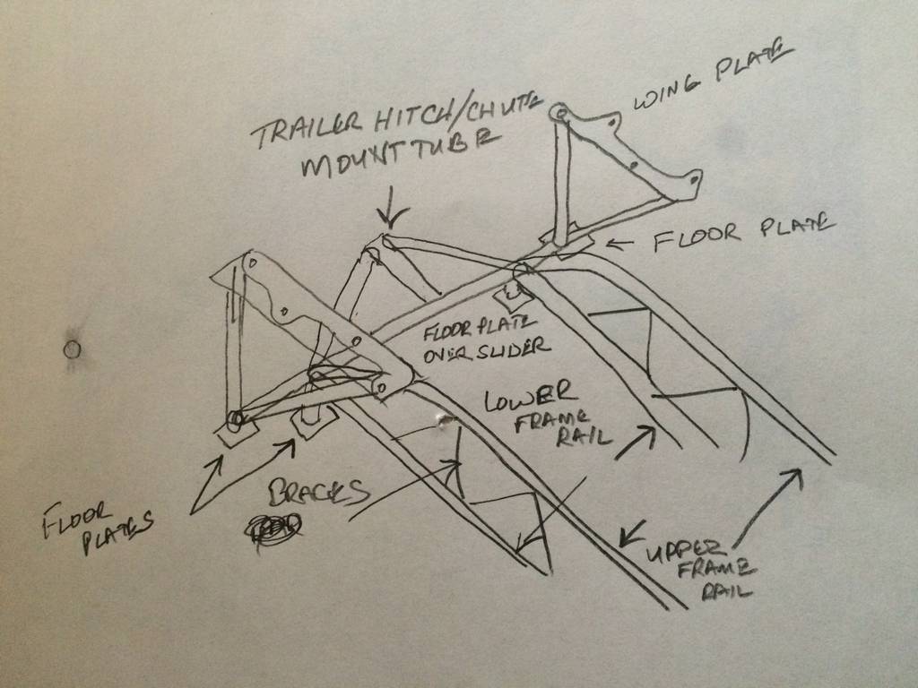

Here's my professionally rendered blueprint done in PencilCAD 5.0 which is my favorite drafting program next to making Cardboard Sharpie Templates.
The upper frame rail will tie into the rear hoop bar and the lower frame rail will tie into the inverted hoop that is welded into the main hoop.
