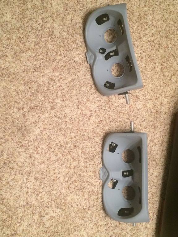

Headlight buckets showed up as did all the decals for the car. I went ahead and ordered the decals since they came from the same place as the wing gaskets.
Are they fiberglass or steel? Look like fiberglass.....
They are fiberglass with steel pivot plates. I'm going to use 12volt linear actuators to raise and lower them. I need to mock them up in the nose and figure out the travel needed.
