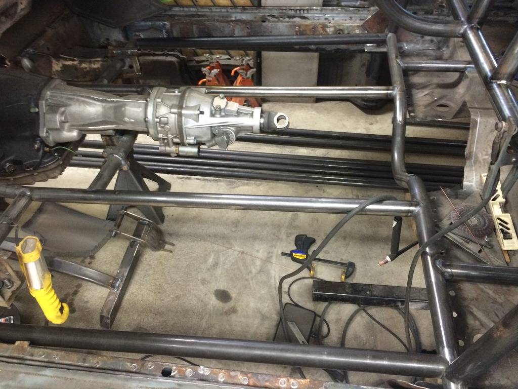

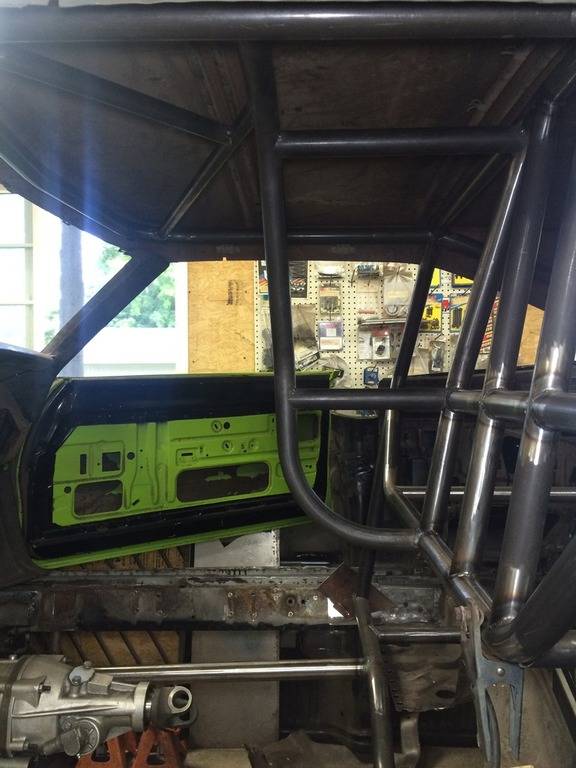

I'm working on the A-pillar bars. These are the most complicated bars in the whole car. The first one was....a near miss. It will make a good template for the next try.

Zooming Your welds.....tidy, looks like nice even, consistent penetration......the kind theres no need to grind and hide. Are You in Cali by chance? Im connected with a project car, trying to find a 'keeper' customer for it & then contract the work on it. Intend to run a good amount of pipe throughout it.......i can jig & tack it together, but id like to have a Pro stitch it......my welds are adequate penetration. but definitely not cosmetically nice....id end up grinding & molding.......would rather see consistent beads.

The SFI spec requires chromoly tubing and TIG welded joints. I have to go slow as there is no room for error and I'm really not that good at it. I consider what I've done so far as "passable" and I don't think the inspector will give me any grief, but they sure could be nicer looking.
