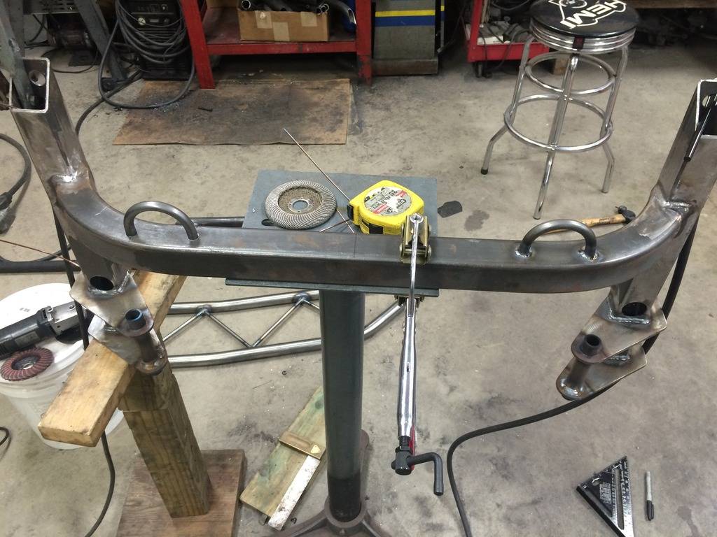

Since I need to pick up another stick of 1" tube before I can make the gussets, I took some time to add chromoly tie down loops to the K-member. They weigh practically nothing and will be real convenient if this thing goes on the trailer or the chassis dyno.

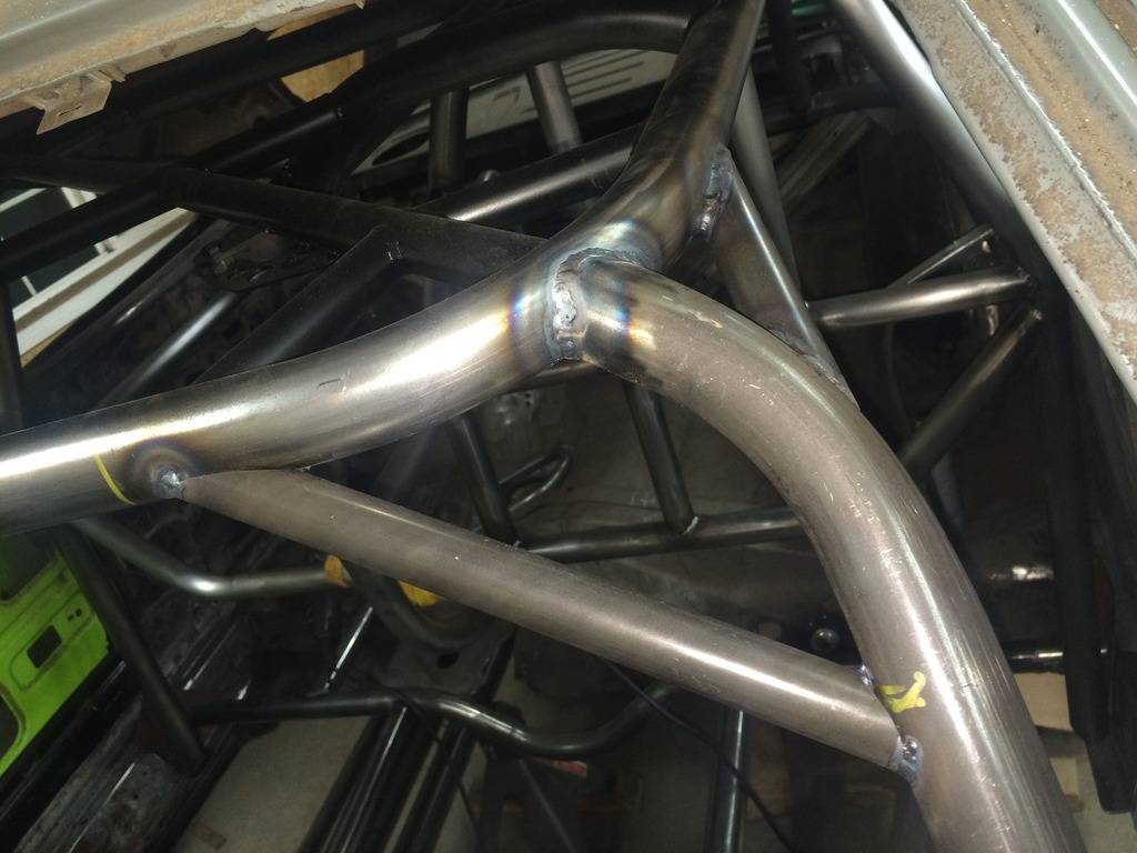

A-pillar bars are in, fully welded with bracing added. I still need to weld out the braces. You can see in the next picture that the cage is still tilted forward and down for welding.
My A-pillar design leaves a lot to be desired. In hindsight, I should have run them straight into the hoop. It would have been much easier to do the bracing and would have looked much cleaner. At this point, I'm just glad to have them done.
A little rattle can black to see how it covers my not so awesome welds!

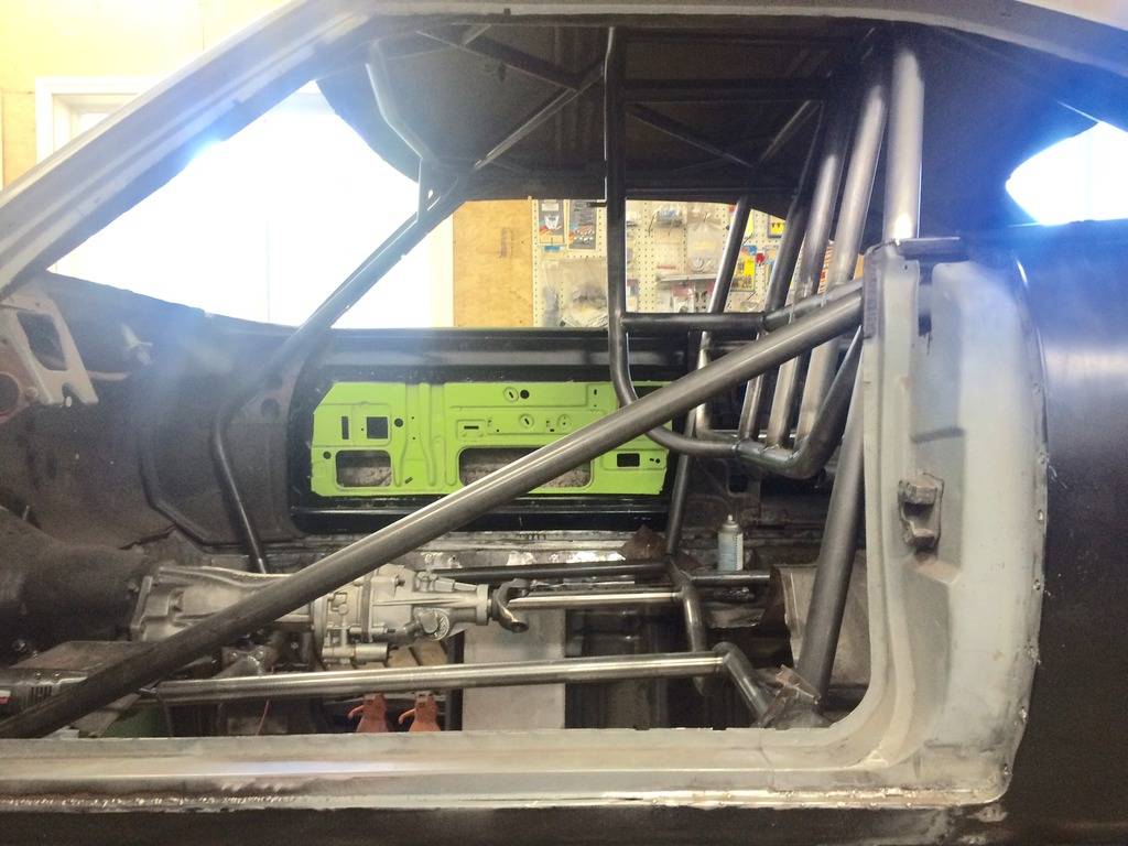

Cage is back up in place and the first door bar fitted. It will come forward one more time to weld the driver side outer funny car bar and brace.
Hopefully this thing slides forward far enough to weld the outside of the joint!
You can see how it exposed the top of the outer funny car cage bar and brace for welding. It also let me do the door bars where they attach to the main hoop. I didn't like the thought of cutting of the door pillars just to weld this, lol.
