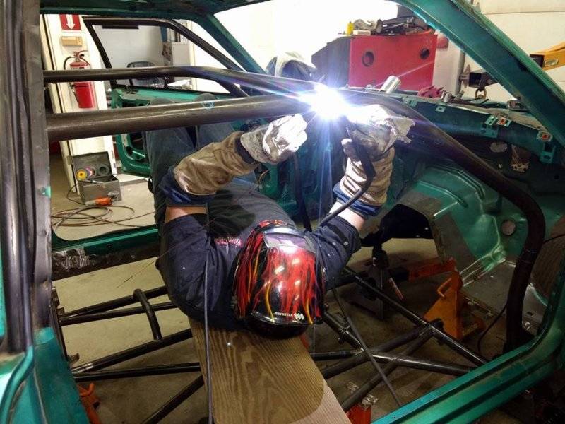

I’m too big to be playing twister in this little car, lol, but it’s been fun. It’s good welding practice. Had to use the “thighmaster” position for the pedal in this one.Looks like your training for a twister tournament! Creative way to use the pedal.

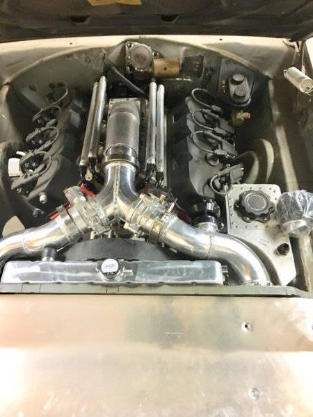

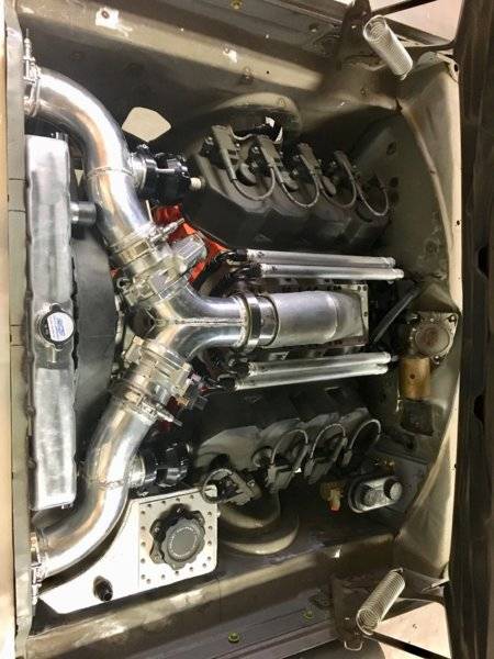

Cold side nearly done. Need to shorten the outside fuel rail so the fitting clearsthe wiper motor and then make fuel rail hold down clamps.The blow off valves finally showed up after being on backorder from Precision. I mounted the first one.
Thanks! I still need to build the catch can assembly and work out the serpentine belt drive. Once all that is done, final assembly of the engine, then engine dyno. Can’t wait for that!Looks very clean and neat so far!

You have managed to merge 3 of my favorite things. Hemi, Turbos, and Superbirds hahaha

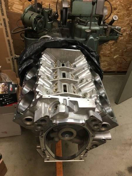

Thanks! It was honed, line honed, decked, and the lifter bushings honed. It’s ready for that Crower crank to show up. Next up is o-ringing the valve covers, oil pan and the intake faces of the heads. Shooting to have the only gaskets on the whole engine be the head gaskets.Very nice!
