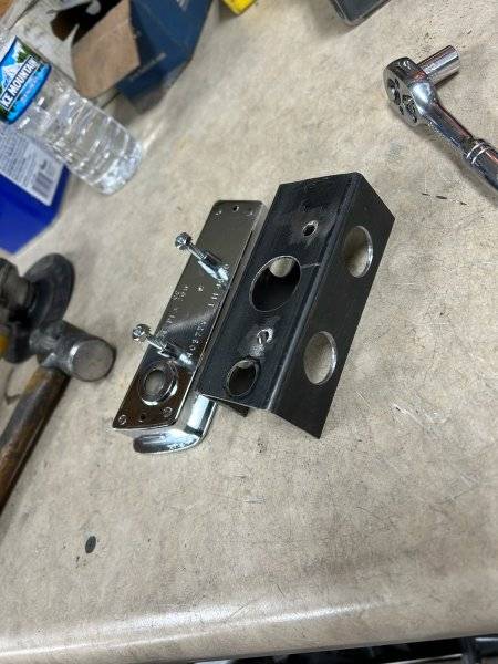

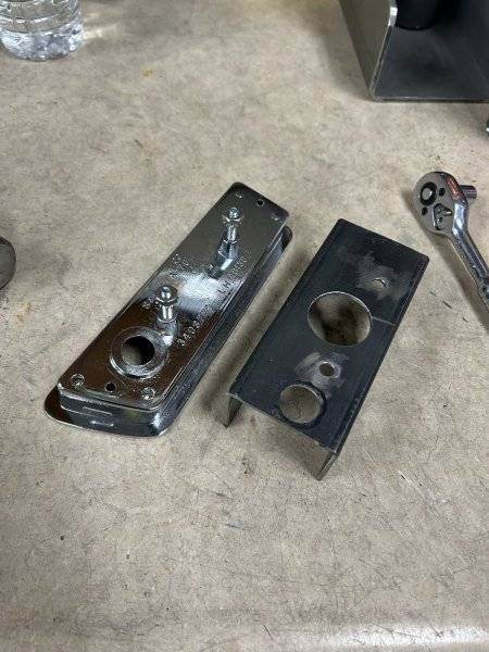

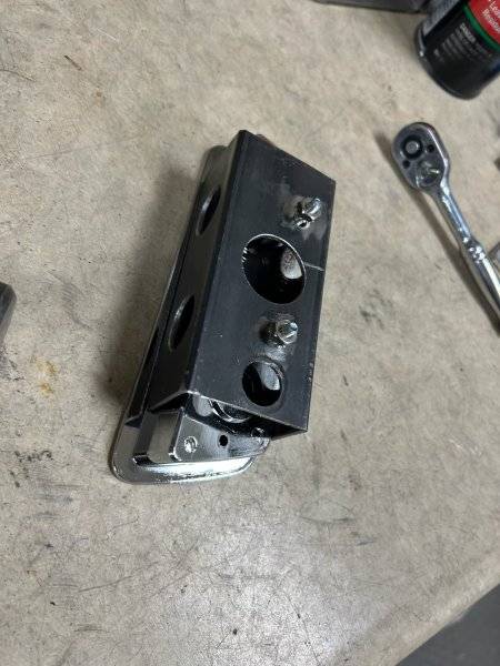

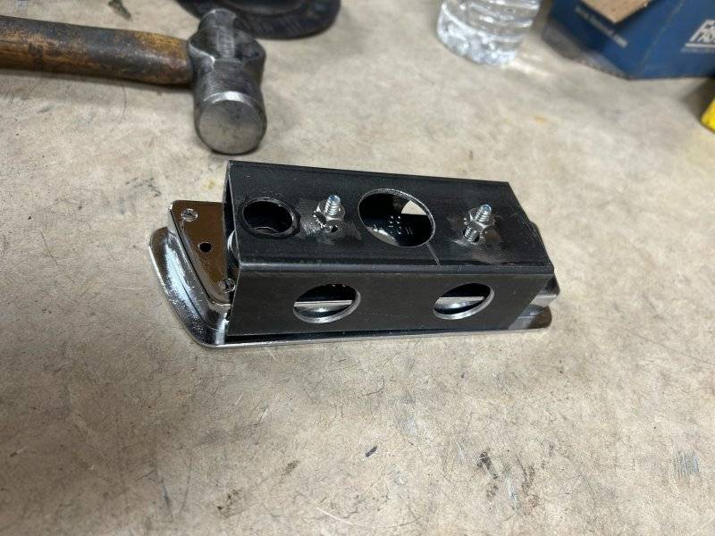

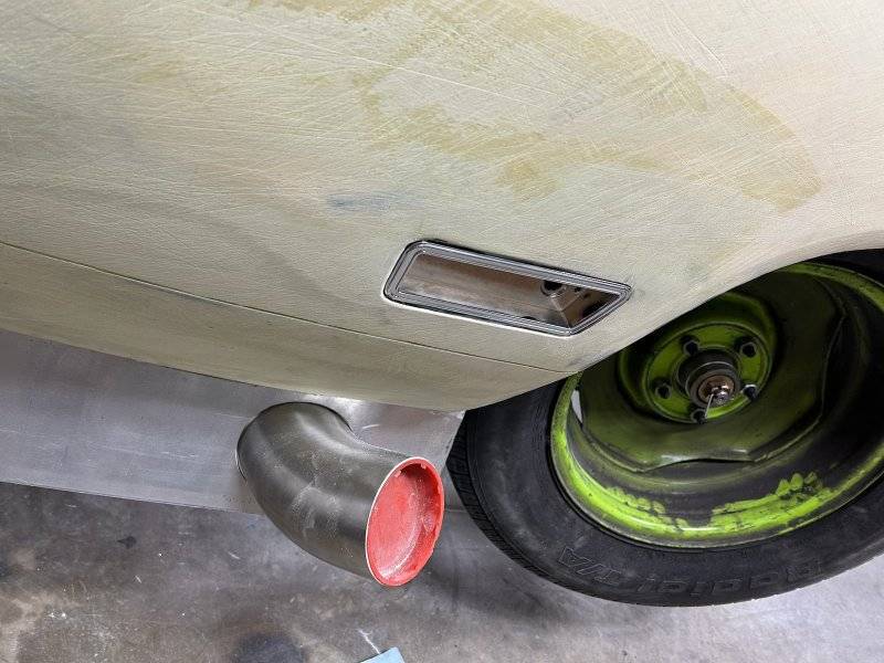

Apparently, they don’t reproduce the funky front marker light retainers for the coronet and I can’t find the used one I had so out come the fab tools and a piece of 2x2 .083 wall. Nothing like reinventing the wheel…

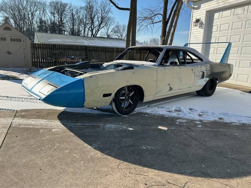

I know there's a good reason for it, but why does it look like that wheel and tire are bolted on backwards?
It is bolted on backwards. It’s the only way these wheels will fit. The steering arms are longer and will clear the 17x4.5” wheels I plan on running but won’t work with these wheels unless they’re on backwards. You can see here I have a set of borrowed race wheels on it and they fit great.

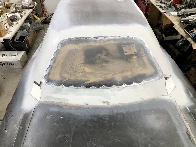

The engine bay is ready for primer. Hopefully I can get that done this weekend. I’ve been working on getting the rear window opening done and the area under the triangles looking right as well. Rear window trim needs a couple of spots welded and it’ll be ready for powdercoat.
I knew there was a good reason :thumbsup:

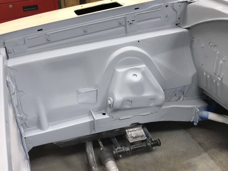

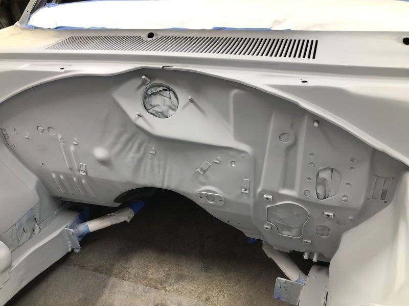

Engine bay got a couple of coats of primer. Needs some creme filler added in spots for the pin holes, but otherwise, looks great.

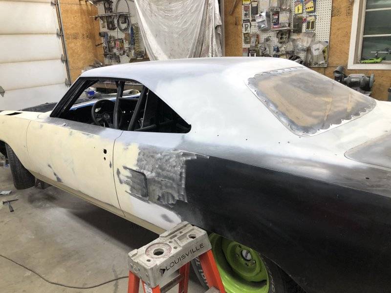

We sprayed the roof while we were at it. It’ll get a couple coats of semi gloss black and a vinyl top on it eventually.
I had to add a little more glass to the decklid to get the gaps even. They’re tight at about 1/8” or so.

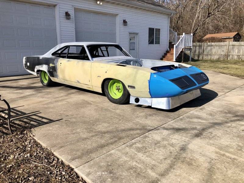

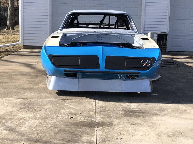

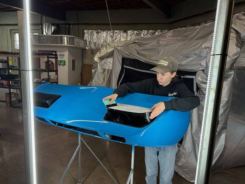

Before I can pull the fenders off for paint, I needed to finish a few things. One is the gap between the doors and fenders and the other is the front air dam. The factory one hints at its true potential but misses the mark for what I need. I didn’t like the slight v shape of the original either. This one should duct plenty of air through the radiator as well as feeding the big 88mm units. It’ll keep air from going under the car and also serve as a stand for the nose when it’s off the car. Currently sitting at 4” of ground clearance. I’ll expect the car to set another inch lower.
You look awfully young to be working on a project like this. It's a good thing that old guy is helping you out. :lol:
That young guy is my buddy Mike’s son Dylan. He’s a die hard car nut and all around talented kid. The old guy is my buddy Mike. I’m the photographer, I’m better behind the camera than in front of it lol.
I’m really undecided as to whether or not I like the chin spoiler. It’ll look much better when it’s trimmed up and painted black.
Looks to flat in the front. What about the old Stockcar style?
More angle forward would definitely help with the look. It’s 3 separate pieces that bolt to the nose and two that bolt to the fenders. I’m gonna finish this and see how I like it as I can always make another. One of the primary goals for this car was the standing mile which needs all the air out from under the car so we’ll see how this works out. The other dilemma is that the nose is removable and the chin spoiler has to act as a stand
That mounting setup was a horrible failure. It wouldn’t easily come off so I converted it to these bolt together tube connectors which perform perfectly. Bolting a stand to it would add time and complexity when at the races but is still an option. I’ve got lots of time to think on it.
