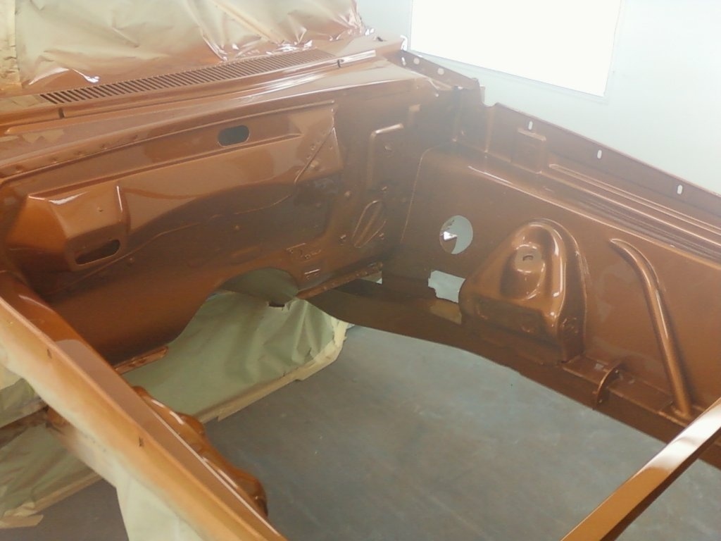

My car traded hands a few times, so no idea who did this. But someone who built my '65 yes, cut and smoothed the firewall.
Nice work! Looks roomy and very clean. The way the wiring was moved, well done.

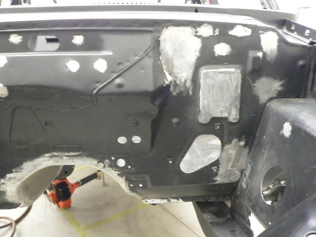

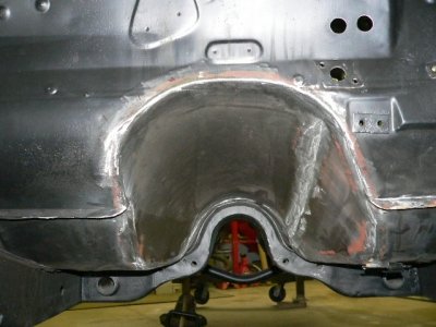

The stock firewall will bend rearward easily. Jerry Stein taught me. Bottle jack on the K-frame, 2x4 on the firewall and a piece of 2x4 between the two. Start pumping the jack, it moves like butter. It will kink the pass side slightly but easily repairible. I cut the tunnel as well.
Doug
Don't attempt this swap without doing what DVW did to his trans tunnel. There's no way around that. He did it right.

Thanks for the advice looks like I might get the car. I was planning on reshaping the tunnel for a future 5 speed conversion. DVW how much did you widen the tunnel?
