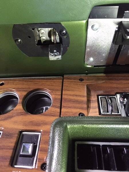

Is this the area you’re talking about Bryan?
My rear window defogger switch sits there. The hole for this was fairly similar to what you are describing. During my past research on the am/8track when i was setting it up, you have 3 dash speakers, and a crossover box. The box attaches to the left of the back side of the glovebox inner, or on top. There is an additional small harness that goes from the radio to the box, and then connects back into the speaker harness. Unless you have rear speaker/s nothing else is required. If you do have rear speakers then a fader switch is required. I can’t find any pics for that for a ‘70 though, so i don’t know how or where that sits sorry.
Yeah that’s where my hole is Monroe. Know that I see yours I seem to recall there’s a witness mark the shape of the oval-ish metal bracket as well as the hole. Maybe I’m getting confused from so many cars over the years, but will check mine out soon as I get over there.
I know there’s a hole there.
Thanks !

FYI that same hole is used for the top up/down on convertibles (which don't have rear window defogger option)
