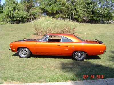

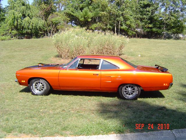

Not that I'm a bit biased, but FK5, Times 2... you don't see it too often, it's subtle enough most kids don't recognize how capable it is, and all in all, it's a beautiful classy color.
My 70 X, FK5, White top, white stripes.

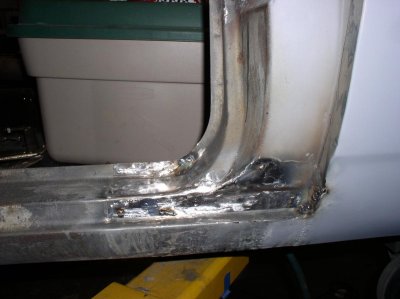

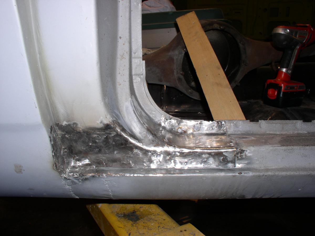

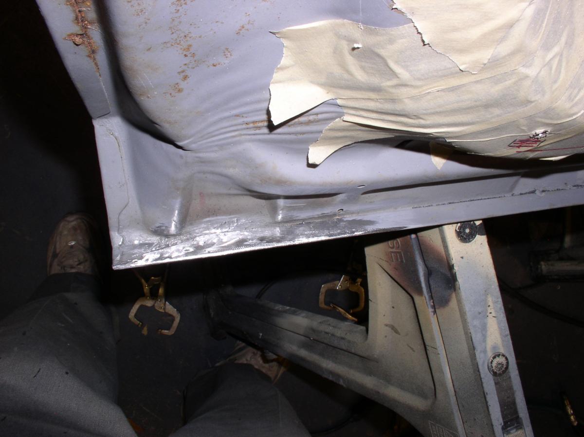

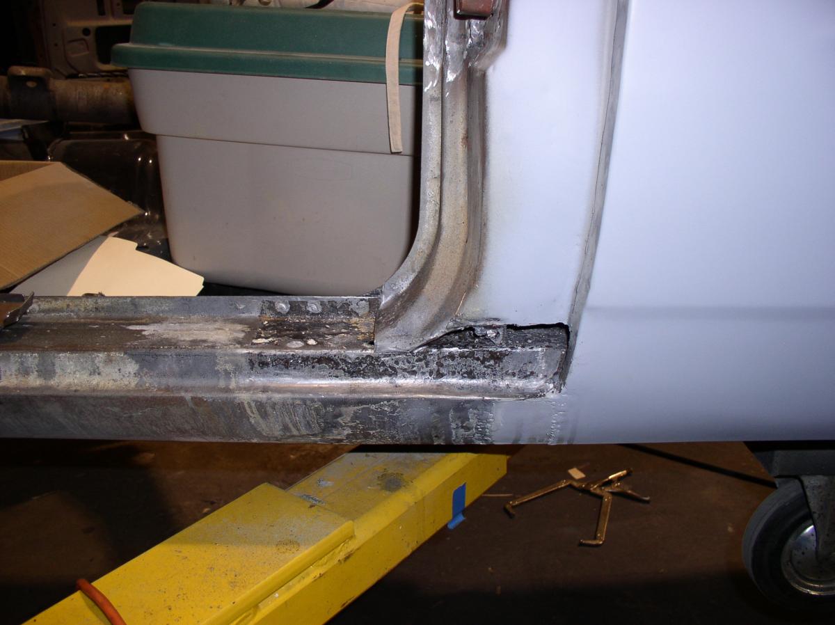

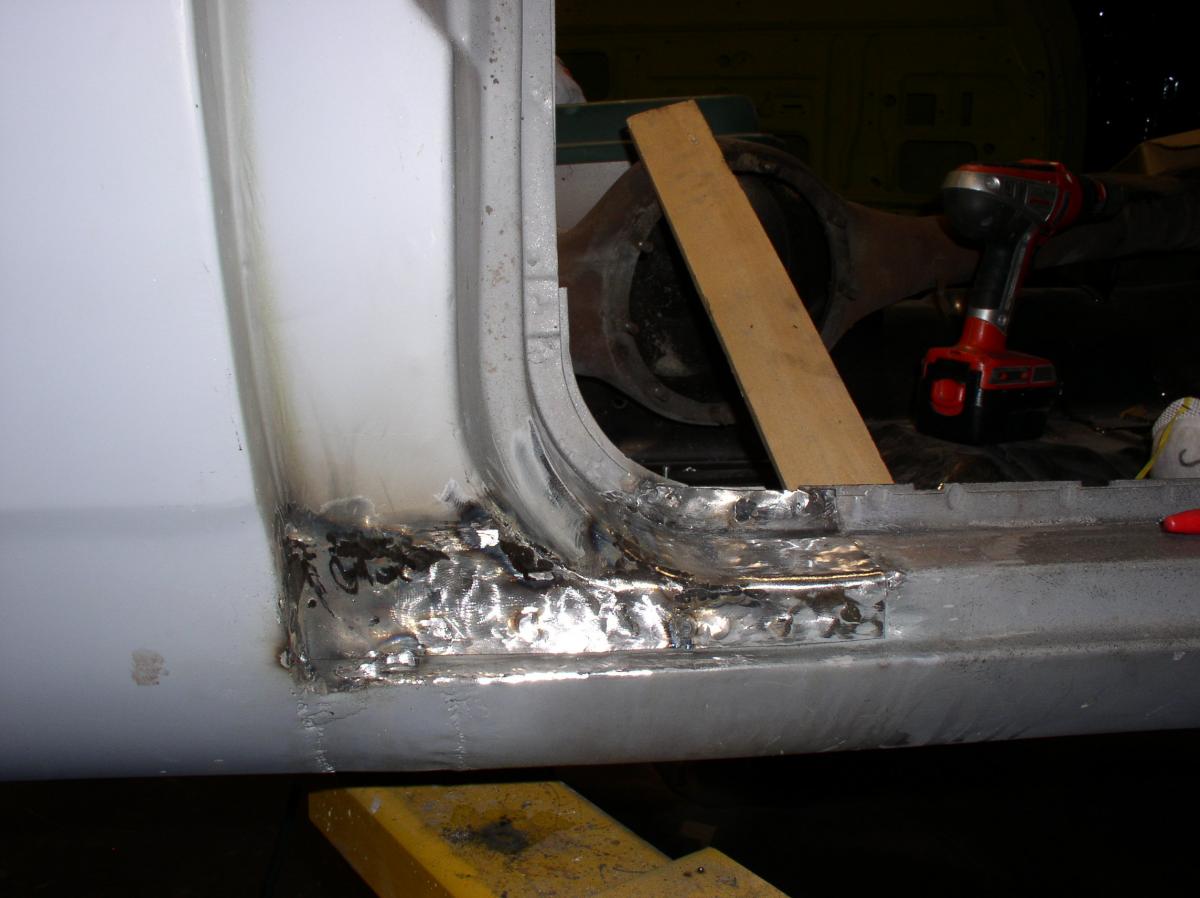

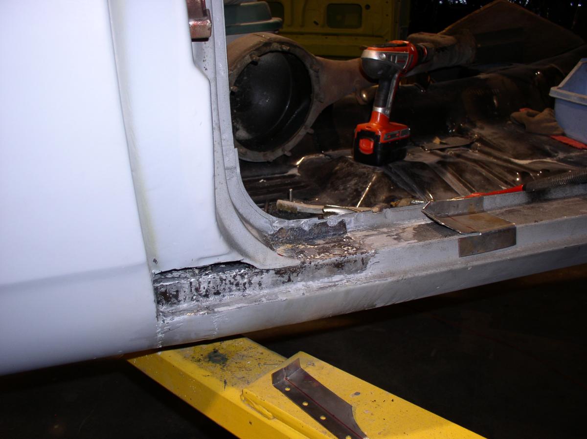

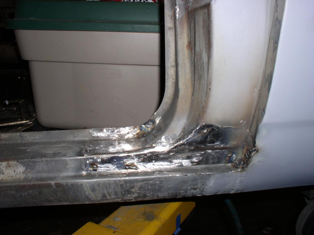

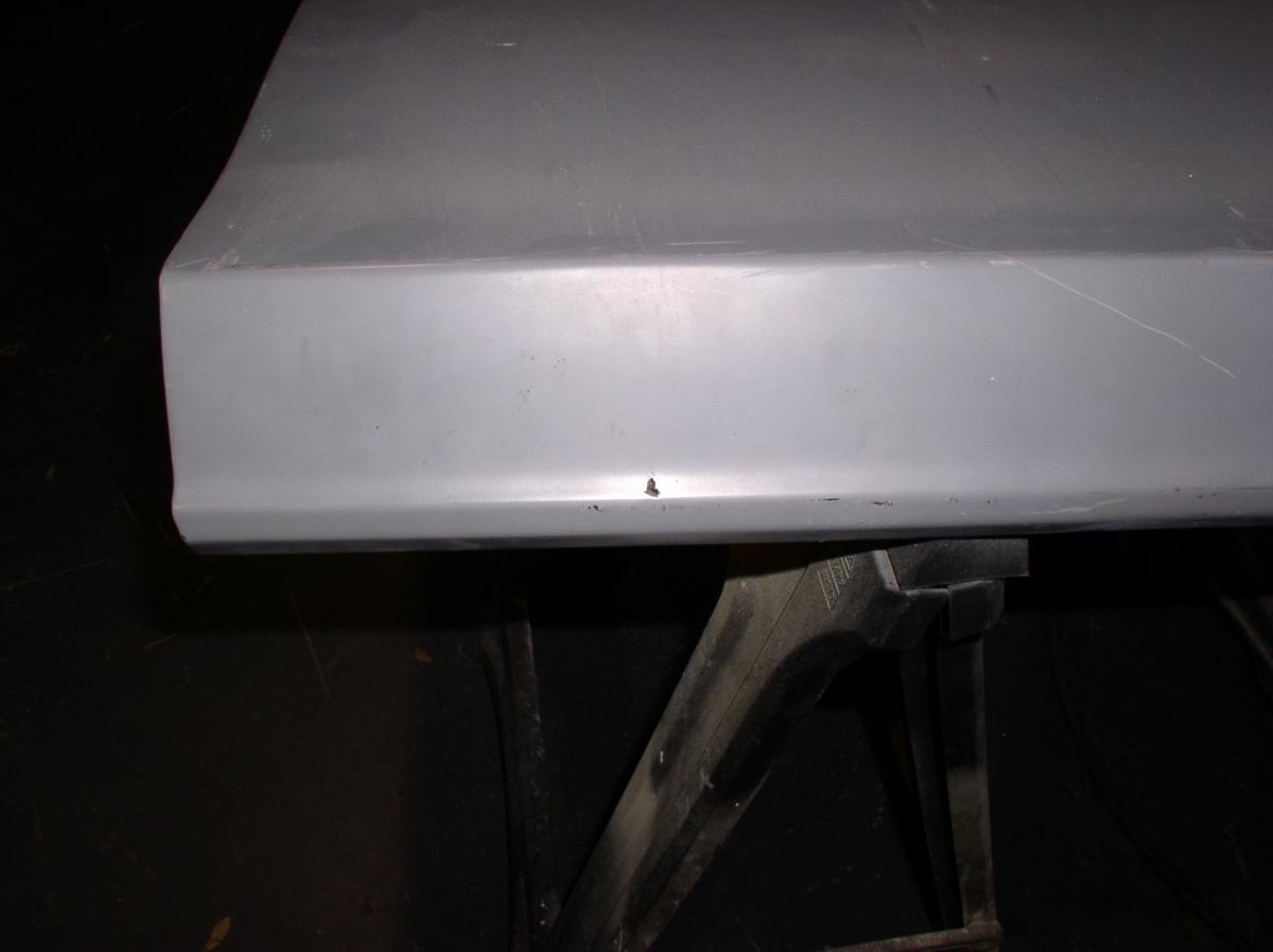

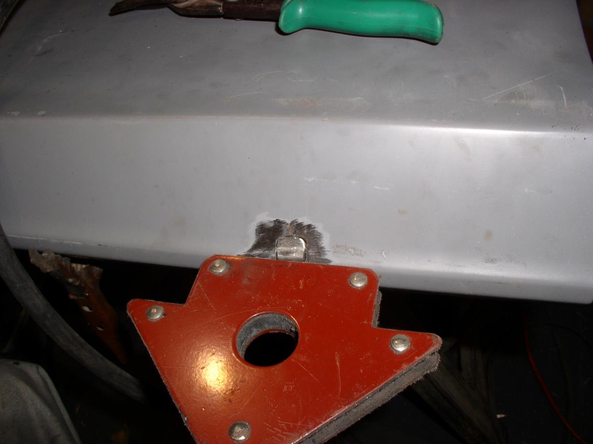

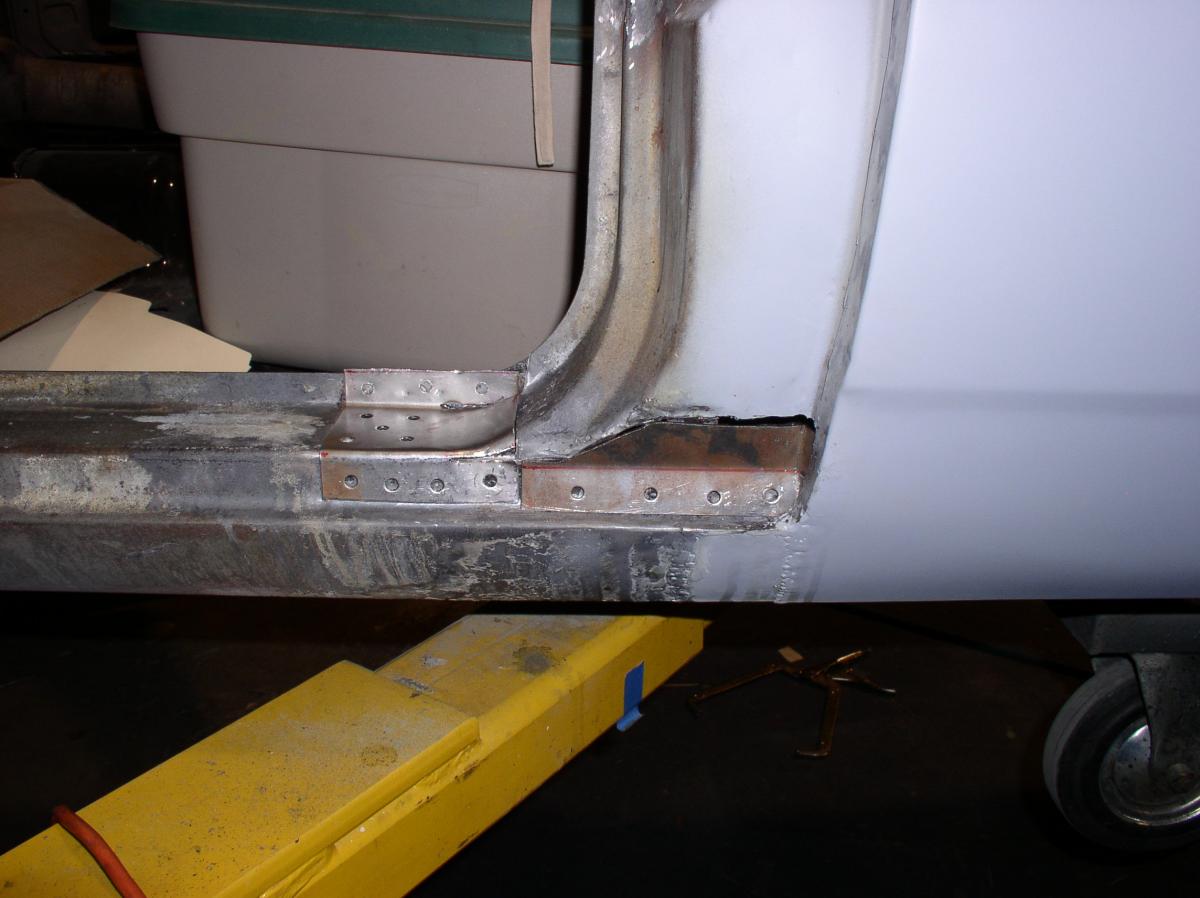

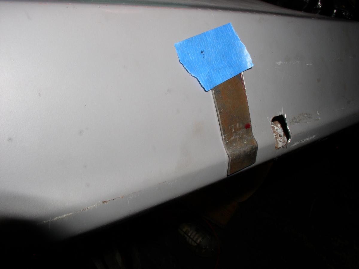

Just letting you know that progress is being made on this 25year project. :walk: little steps are being taken. Welding and patching are almost complete. It is almost time to dig into the priming and blocking of the different panels. I am trying that Rust Bullet product for a base below the primer. Reading some of your posts of your projects makes me think that you all swear by it. Since this car has been in all stages of completion for a long time. I would like to have a good foundation for the paint. I do not want any problems popping up after the paint is on. Here are some pictures of some of the repairs encountered in the past few weeks. If anyone has any recommendations on the use of the Rust Bullet let me know. Thanks

I use rust bullet quite often. I do make sure the corroded metal I cover it with is clean as possible. Even if that means a wire wheel, grinder, sander or blast. I use it on fresh metal as well just to add an extra barrier of protection. Stuff is hard as a rock and almost impossible to get off your skin. Be sure to buy the silver "automotive" stuff. It has a lot more aluminum in it than the black.
I have 3 spots on my 68' Coronet I coved up with rust bullet several years ago. I have seen no issues on that as well as a couple other cars from the past. Be sure to scuff it well before painting/covering. Being it is so hard and dries over with a smooth surface, it is definitely needed. I go over with 220 grit.
The stuff was originally designed for the USAF, in an effort to seal/lock out corrosion and have a coating on wingtips that could withstand the crazy amount of dynamics assosiated with aircraft. It made its way into the industrial word with great results (which i've seen), and automotive to..
Good stuff! Not cheap, but you get what you pay for usually..
Good luck!
