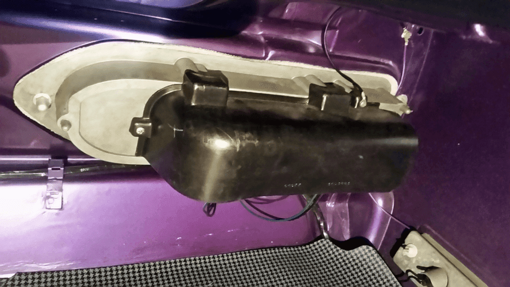

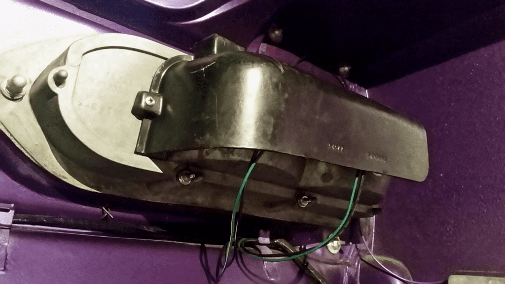

I probably didn't use the factory OE fasteners, but I found screws and fixings that were the correct thread and length....my car was partially disassembled when I bought it....
I hope they help. :thumbsup:
BTW, the foam gaskets under my tail light fittings appears to be the source of my trunk leaking....the gaskets came from YO at great expense many years ago. I would like to know if anyone has a suggestion for a better alternative. :)

You know, my car was un-molested when I got it and there was "dumb-dumb" putty around the holes/studs/speed nuts where the outer tail light housings come through the trunk. Maybe you could find some of that stuff or remove the speed nuts, put a dab of clear silicone in the hole/stud area & replace the speed nuts? That's be my guess anyway. I can't see how the foam gaskets themselves would leak???
