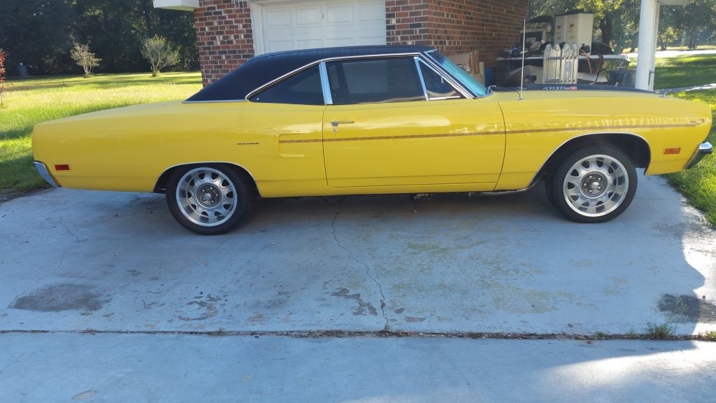

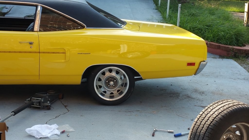

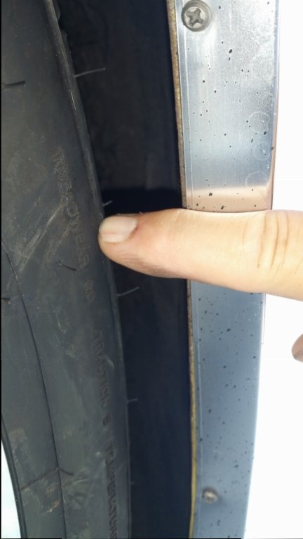

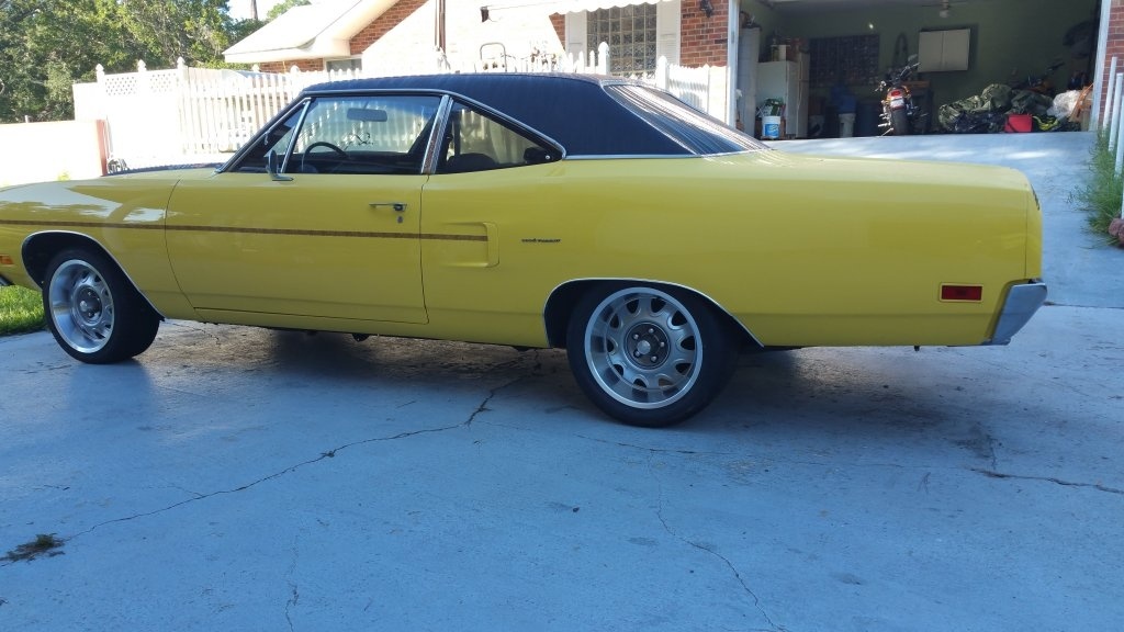

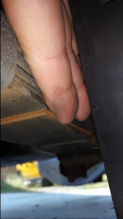

I bought 8s and 9s from Classic Industries, 17" diameter Rally style. I had a pair of Toyo Proxes TQ drag radials mounted and balanced on the rear 9s. 315/35/17s they fit (easily IMO) between the leaf springs and fenderwells. Just over 1" of clearance to the chrome wheel well trim and at least an inch or more between the springs and tire. More precise measurements and pix will follow, but I am very happy. All stock body and suspension, only the wheels are aftermarket.
Stock 15" Rallye front, New 9x17 rear. For comparison. I think they really got them right!

While I would like the appearance of a taller sidewall on the rear tires, I think the "35" profile is a big part of why the rears fit without fear of contacting my inner wheel well. I can see the top part of the inner rear fenderwell has a curve to it. What was a priority in getting the widest drag radial that I could on my new wheels was TRACTION. The only track day I had was last November, and traction in 1st gear at any speed at WOT was non-existent, and I "feathered" the throttle on numerous runs, but every time I floored it in first my old tires would spin. I am very excited to try out these Proxes TQ drag radials on the street and strip. More pix to follow.

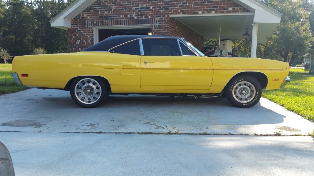

225/45/17s is what I ordered. I was concerned that they clear the front fender corners. They fit fine and look good. Finally have all 4 Classic Industries aluminum Rally wheels on the Roadrunner and they look great. Purple Mohawk done today, now just need to get the GTO motor finished in the engine builder's shop and get that motor and her transmission back in the GTO, and my a833 back in my car...by Monday at the latest.
Front 8" is 4 1/2" backspace.
Rear 9" is 5" backspace.

Can you imagine the "Car Magazine" road test 1/4 mile times if the factory would have put these on the cars? The rear wheels and 315/35/17s Toyo Proxes TQ drag radials fit like they could have been factory!

They look great. IMHO these cars need bigger wheels but that usually translates to bling, which seldom works. Yours fill out the wheels with a nod to period correct, well done.
That Lemon Twist with the black vinyl roof is an awesome combination !
