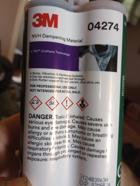

The inner support is starting to separate and would like to know what type of adhesive puddy can be used to fix ??
Thanks for any advise.
panel bond will hold it, no doubt...... this is closer to the actual stuff
My initial post was for panel bond.. But the other is supposed to be somewhat flexible.
