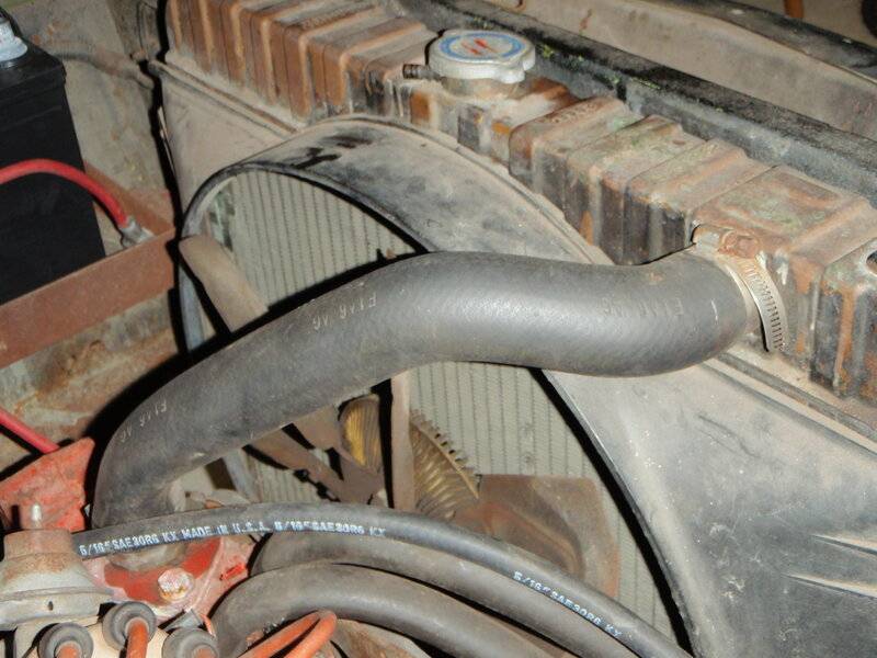

I have a 70 Air Grabber Road Runner. It is a 383, 4 speed car that came with a 26" radiator. It has the A36 Performance axle package that came with a 3.55 Sure Grip, HEMI suspension, HD cooling.
Below is a picture of my car before restoration. Not a great picture, but you can clearly see the clutch.
So yes, I believe a car with heavy duty cooling (a 26" radiator) came with a fan clutch.
Hope this helps confirm what you needed.

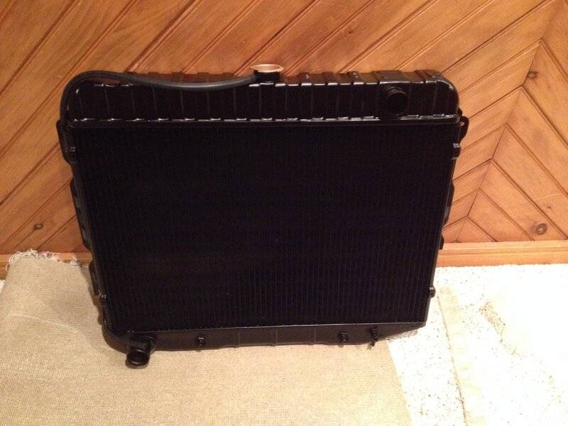

If it helps, my RS23V0A****** GTX with the A34 super track pack, Max cool radiator, totque drive clutch # 2806070, 7 blade fan, shroud, 4.10 Dana, PS/PDB, my radiator is # 2998956.

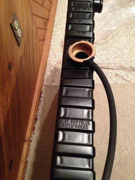

IMO....you are correct....the A36 package includes HD sudpension, the 26" max cooling radiator, # 2998956, which included the # 2806070 torque drive fan clutch and shroud. As Hawkrod noted, he also has the 3.55 rear gear. If so, and he has power steering, then he SHOULD have the PS pump oil cooler, regardless of the pump installed. (My GTX has a Saginaw pump, oil cooler and the 4.10 Dana gear but because of the "V" engine, HD suspension was included, and everything that went along with the A34 package). According to Galen Govier's white book, the #2998956 radiator is used with auto trans (water to oil heat exchanger in bottom tank) AND the 4 speed cars, (heat exchanger not plumbed in). The 3rd pix shows the trans oil cooler connections, present but not used. I guess it was easier to make one style radiator for both applications.
