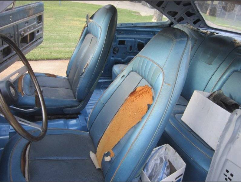

Will 74 A-body buckets fit my 70 RR.
Are the tracks the same.
Can you put 70 RR upholstery on them.
Thanks
The seat tracks are different and the seat foams are different....
I had 73 Duster buckets in my car for awhile. Had to use the 70’s seat tracks (one year only) But the buckets bolted to the tracks. The buckets are a completely different design.
I’ve seen 70 RR’s with high back bucket seats and low back with headrests.
What’s correct?
High backs are correct for buckets. Head rests are on bench seats.
Look like 68-69 seats. Tracks should fit a 70 floor.
