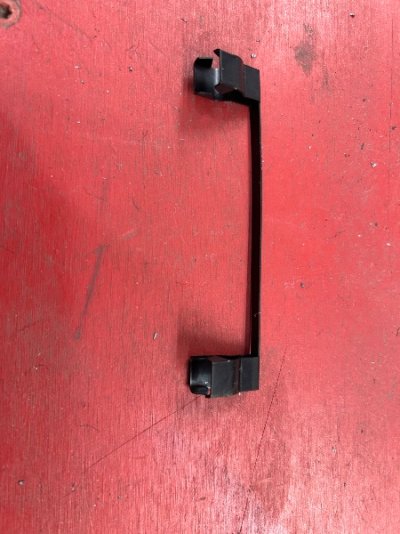

Hi,
Going back together with a factory fuel tank after 25 years with a fuel cell. Can’t remember exactly where this ground strap goes. I know it’s from the tank pinch weld to the frame but I would like it to be in the factory location and my FSM is pretty vague.
Thanks in advance for any help.
Dennis
One end on sending unit and across the rubber hose to the main steel fuel line.
Thanks,
Shows how bad my memory is after 25 years. lol.
I’m going to have to go to plan B since I’m using steel braided fuel line.
Thanks again
Thanks,
Thanks again
I soldered mine to a short piece of wire, drilled a hole on the rear shock cross brace & grounded it right there
