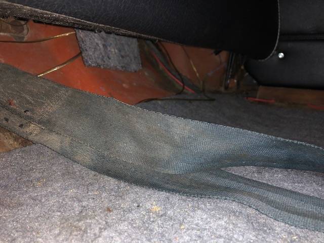

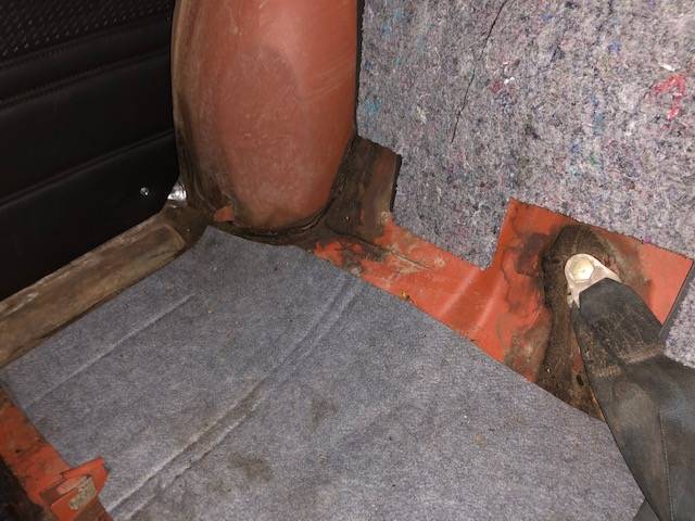

Does anyone have a picture of how the rear seat belts in a 70 RR mount to the body? Just got my hands on a RR and it is missing the 2 outside male seat belts. Don't see anywhere to mount them. Thanks

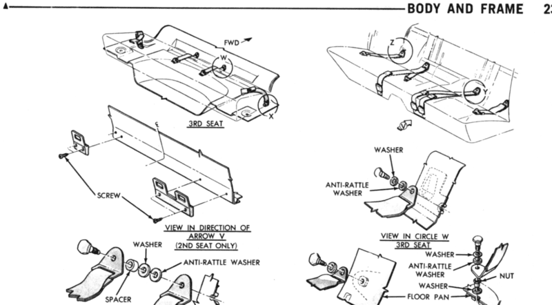

Top right picture.. This is a 69 satellite but should be the same locations for the 70
You have to pull the seat bottom to mount them... there should be a hole in the rear door panel down low
I feel like I am missing something. I took the seat back out last night. I don't see anywhere to attach the side belts.

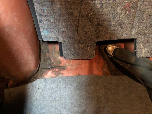

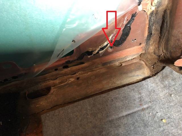

Look underneath the car... It's hard to tell from the picture, but it almost looks like they've been filled in....or there's a patch panel there? If that's a patch job there likely isn't an insert visible from underneath either..hmmmm

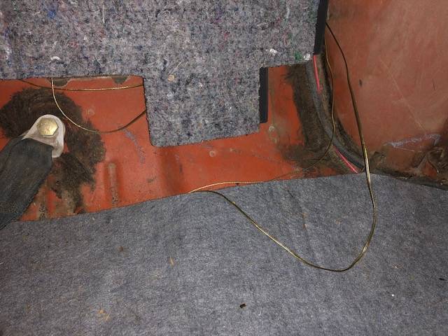

Take that inner quarter trim off, the belt pivots from the inner corner side.

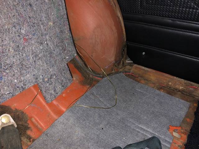

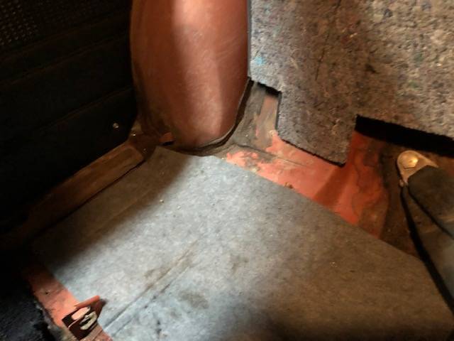

Up in front of the wheel well? I didn't know 70 was that different thanks for learnin' me something!
Think I found it. You had it WileRobby. It appears it was under the side panel. Thanks for everyone's help.
