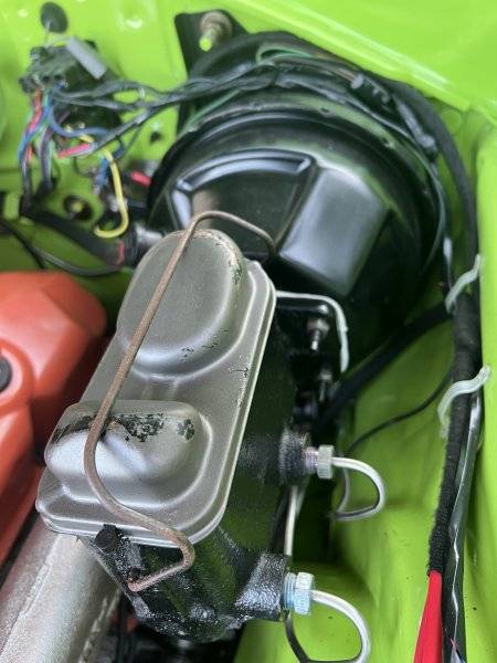

70 super bee power booster, puffs air noise when I apply brakes.
When I apply the brakes slowly I do not get the air puff noise .
The hole brake system is brand new. Brakes are bled multiple times. Pedal feels OK maybe a slightly low pedal.
Fronts are disc/rear drum
Any clues on why this may be happening?
Thanks for any advice that you may have
