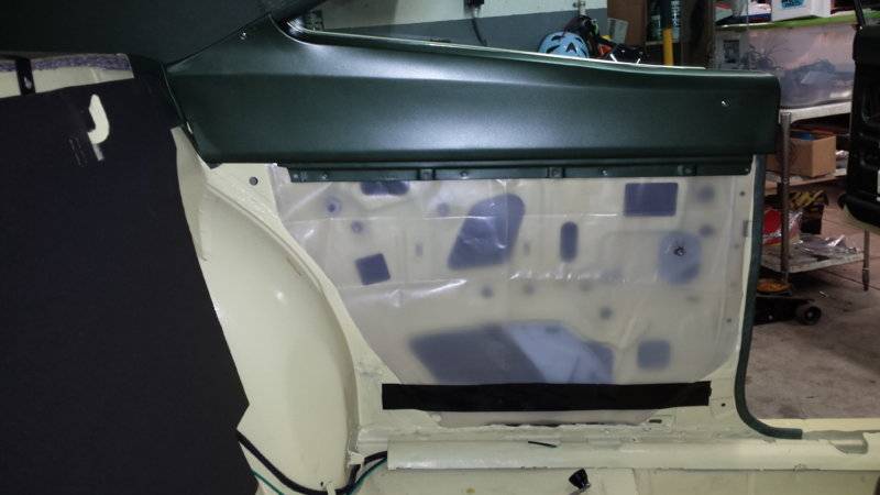

putting in my new door panels and something is missing. Is this what Im looking for?
sorry this is my car pic with hole
:BangHead: love my mopar,love my mopar
so then the weather strip gos on it? Any pics please
Believe you put the moisture shield on first, then the upper trim. The stainless J-shaped trim piece goes underneath your painted piece next. Last thing to do is snap the panel into place . One word of advice. Don't rush and get in a hurry like I did. Read the instructions that come with the panels unlike me and hopefully you won't get the small raised bumps from the head of the clips visible. clips[ATTACH =full]588853[/ATTACH]

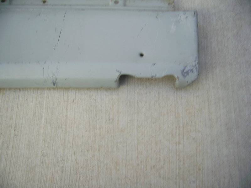

was there one that had a center post ,mine seem to be cut out on the top for a post between the windows? look at my pic.
ok I think my upper panel is for a 70 roadrunner with center post :BangHead:

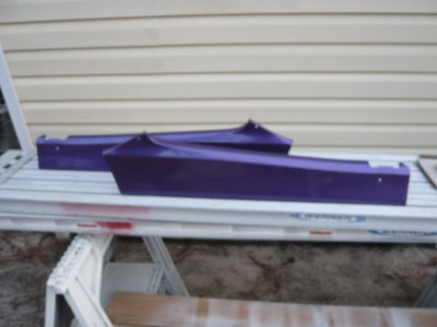

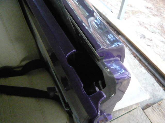

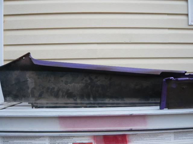

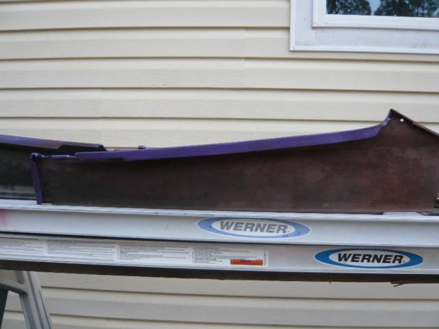

Here's the hardtop pieces. Somebody put some funky paintjob on them to match their nice upholstery job they had but it did protect the metal I guess.

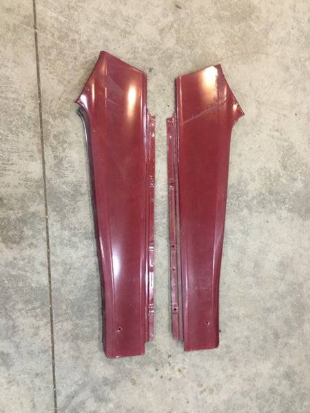

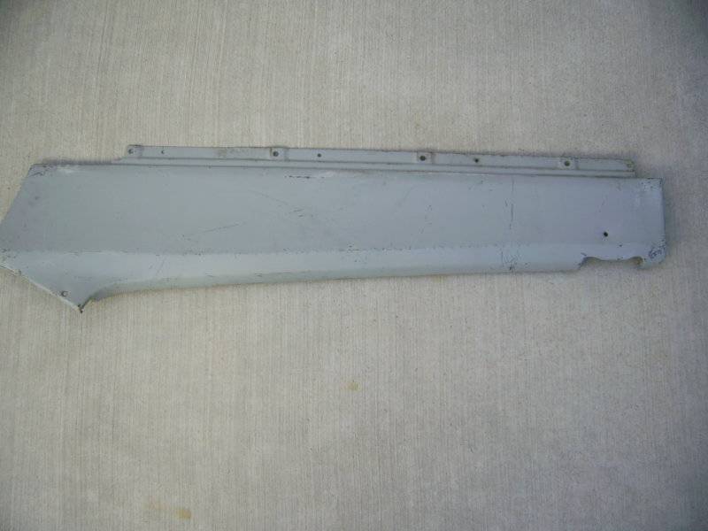

I have a 70 Road Runner RM21 post model and in need of the left side upper rear trim. Photo is what I have for the right side, and I have 2 of those.

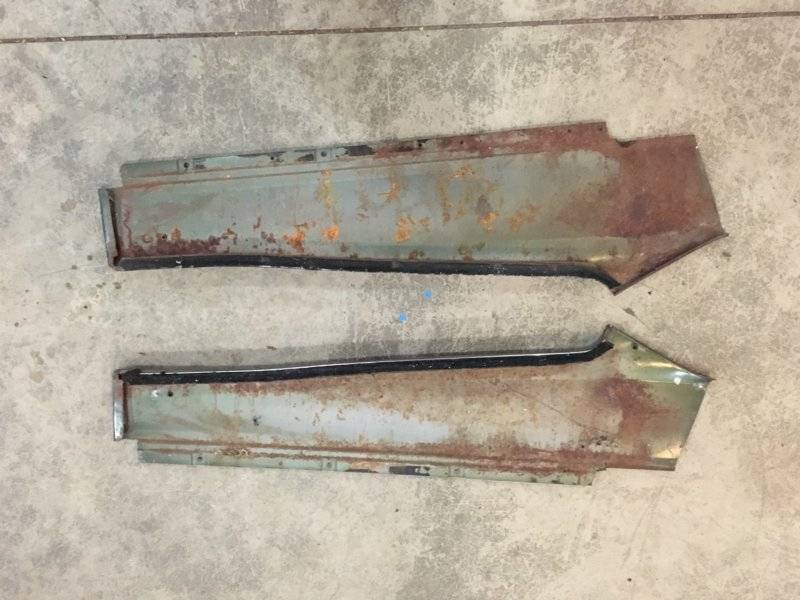

here they are pm me if interested
