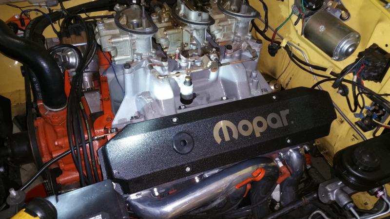

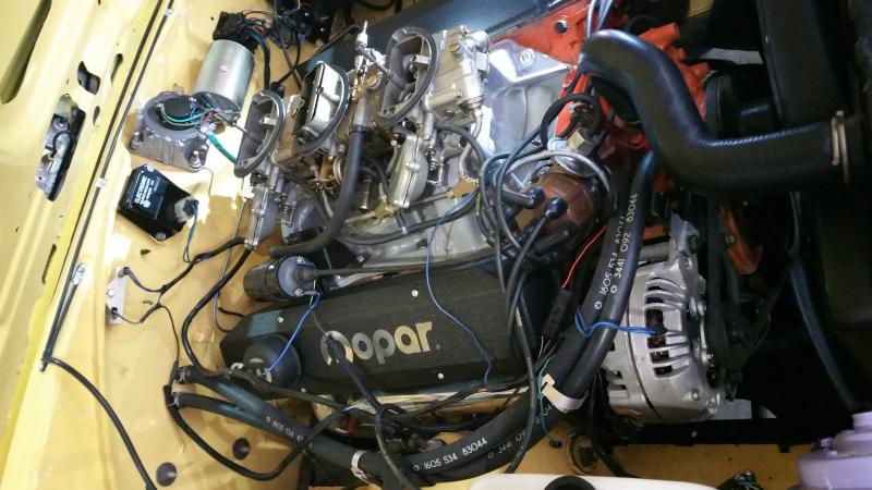

Last show I was in was Mopars at the Battleship. I decided to install TTi ceramic coated polished 1 7/8th primary tube headers and the mini-saga began...found my 18 spline a833 was leaking from the front seal, so I sent it to Passon performance for a complete overhaul and to have the slick shift synchronizers and sliders installed. Jamie Passon did a thorough inspection and we decided to replace 3rd gear and the input shaft too along with some other parts. I also got a new McLeod clutch disc and pressure plate and had the flywheel resurfaced. New steering gear box as my old one was leaking. I also had a snapped manifold stud so when I was getting that drilled out and tapped I had Ebert's machine shop check the valve springs pressure which was down about 35% so I got a set of Comp Cams springs, 10° locks, and retainers for both heads. Well, I JUST fired it up yesterday (the goal was to have it ready for the week of Cruisin the Coast Oct 3rd through 11th and it was awesome to hear it running! I have to complete the exhaust by installing my 3" diameter Doug's electric cutouts and an X pipe which then will tie into the existing 3" FlowMaster muffled system. Shifting is crisp and precise with a nice precise "click" "click". Clutch pedal effort is significant, I am going to have a weird looking "running back's" left leg by the time I have finished cruisin the whole week in traffic at Cruisin the Coast LOL. Still have some tidying up to do, but see pix. 20150926_131142.jpg20150926_130712.jpg

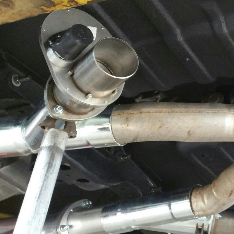

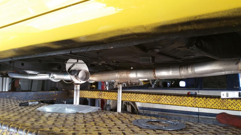

Update: car runs better than ever! I credit the new valve springs from Comp Cams (that replaced the worn stock springs that were down by 35%) Pulls strong all the way through the upper RPM range instead of the previously noticeable roll off in power. Transmission work by Passon is incredible! Used to feel like I was stirring a bucket of $hit and bolts, now it's firm and crisp. I got the exhaust finished today with the 3" Doug's electronic cutouts and X pipe tied into what happily turned out to be a 3" (not 2 1/2") FlowMaster existing system. Cutouts open and close FAST in about 2 seconds!20150928_110850.jpg20150928_110959-1-1.jpg
You might want to put some turn downs on those cutouts so you don't burn the interior carpet. I use turn downs on my QTP cut outs.
I am leaving tomorrow for a full week of Cruisin the Coast. I will evaluate floor heat as I am sure there will be lots of stop-and-go traffic (I mean cruzin' activities)
If the floor starts getting too hot, I'll just close them for a while. Thanks.

Great looking engine and bottom. How about some pics of the rest of the car when you get time. and pics from the cruise of the other mopars you see. Enjoy your time cruising.
See "Mopar Events Meets and Car Shows" Cruisin the Coast pix thread
Engine bay looks outstanding and you will love those cut-outs!
Can't wait to see some pic's from the cruise! :icon_salut:
