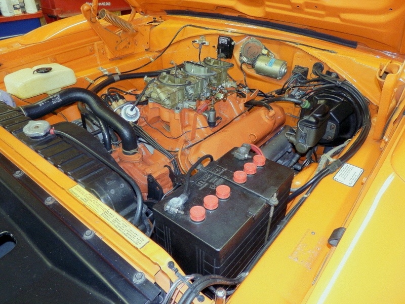

I'll make a minor adjustment to your first sentence,hard starting after sitting is a common problem with "SOME" 6 pack cars.Finished this 4 spd in 1992,Carter 8 psi Hemi pump,101 AV gas,choke set the way it is supposed to be,can sit a week,month or longer and will start in no more than 5 revs and you can drive it away.
