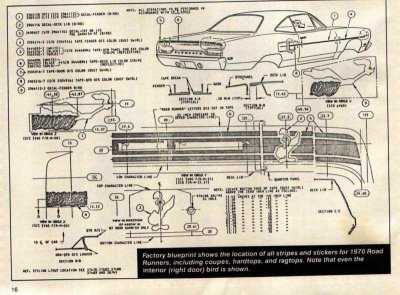

anyone know where i can find the specs on 70rr fender bird decal location
if you have no luck,this weekend
i can get pics and measurements from a
original paint car that has fender birds with no dust trail stripe.
just let me know.
IMG_1920.jpgmycomputer will not download the performance car graphics info.so if one of you guys can post a pic and or specs for the location of fender bird.all help very appreciated.thanx randy
Not sure if you can read the numbers on this or not or if you can make sense of all the jumbled numbers, but this is from the factory courtesy Rick Ehrenberg. If you can't read the numbers, you can send me a PM with your email and I can send you the pic through email.

i just pm you my email or you can put it on this post.thanx alot
here is where ma mopar slapped them on
this is from the top of the fender to the nose
from the front of the fender before the bezel to the nose
