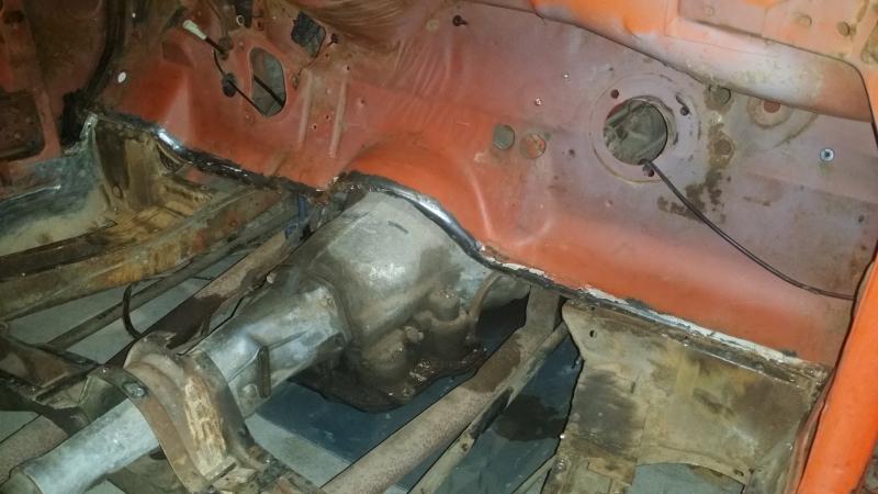

I have kind of a dumb question. I am removing the front floor pan on my roadrunner and I can not figure out how to separate the front of the floor pan from the body. I don't think it's hard but I don't know where the welds are at. It's the only thing holding me up at this point. Any help would be appreciated.
what you can do to make it sort of easy is
make a cut across the floor a few inches away from that flange
and remove most of metal in that area to give you better access
then it will make it easier to reach and be able see those welds on that flange.
the only way to get to/see them is laying on the ground looking up at the flange
from underneath.
Is it just the two flanges towards the outside or are there more welds I can't see? I have to be very conscience of noise because i'm in an apt garage and my grinder is loud :). I'm just having a lot of issues with that blasted lip.

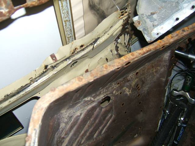

give me a few min
i can show you some pics of that flange separated
go look at what you got again
you are going to have to get into the eng compartment
and hit that flange with a wire wheel to expose all the welds

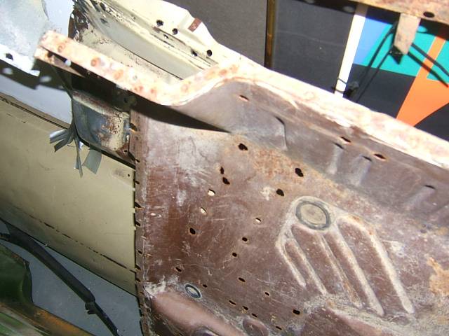

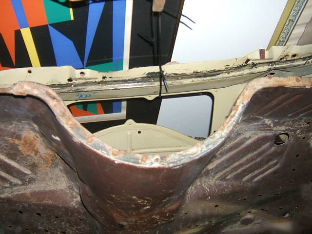

this is what that flange looks like when removed intact
this is a original donar floorpan i have
you should be able to see the welds that you need to get to.
if you cut the floor along that flange and remove most of the metal
in that area will give you better access to the welds
Yes, there are 3/8" spot welds all along the two lips that come together - a real pain in the buttocks. It took me a solid six hours to drill out all the welds and free the pan. The blair spot weld remover bits are well worth the money on jobs like this. Good luck! Scott.

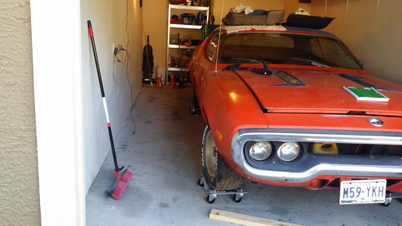

Thanks everyone for the help and advice. I was able to get the floor pan out with out much trouble and now it's time to start cleaning up and prepping for the installation. I was able to get it out without removing the transmission but it will definitely have to be taken out now. It's not the prettiest but I hope to make it look good again. I wish I could work faster but this is all the space I have and for some reason my upstairs neighbors don't like hearing a cut off wheel and drill. I feel awful about the noise but it's gotta be done thankfully I don't have much more noise to make.
