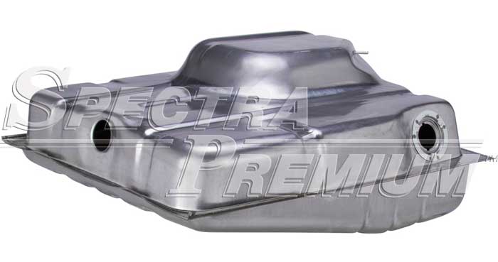

I'm being told that the 74 gas tank is different than 71 thru 73...is that true? shouldn't 71-73 gas tanks fit in my 74 charger without any issues?...im not looking to restore back to original....just curious
The tanks are very different and the 74 tank is very very expressive. If you put a 73 tank mount under your trunk floor you can run a 73 tank
1974 B Body trunk floor has a hump on it for the gas tank due to mandated emissions in 1974. I forget what they added on top of the gas tank but it is emission related. Also the gas tank straps are different, the strap bolts are positioned opposite of the 71-73 B Body. Instead of the "J" bolts being at the rear of the tank (closes to rear bumper), for '74 they put the "J" bolts at the front of the tank (by the rear axle). 1974 gas tank straps are also hard to find. People have been known to take 71-73 straps cut the ends off and switch the ends by welding them back on.
So as Bb70charger500 mentioned you can put a '73 tank on your '74. The trunk floor hump will serve no purpose. I'm not sure if the '73 straps will work on your '74 w/o doing mods.
Let me crawl under car and check it out I have the 73 tank straps also
I am not 100% certain of this but I think the vent manifold is what is in the 74 hump, instead of a separate part in front of the tank on the 73.
Also, M body gas tank straps are the same as 74. The tank side profile is the same, but the tank is wider!
Not sure if F body is the same or not.
you can keep the 74 straps and use any tank you want. Per what I understand you are asking about the gas tank itself and not searching the straps

71/73 tanks are same size and shape but diff air vents location. 71/72s got a vapor reservoir attached somewhere into one of the wheel wells so vapor tees are on one side. 73 not, but tees were moved to the front of the tank and lines runs up to the vapor canister located on engine bay. 74s just one tee at the mentioned hump
74s ( the hump is the only phisical difference with earliers )
the price diff is not because the hump itself but the hump contain some lines inside for whatever vapors reason.
I did a swap about 30 years ago when my gas tank got a hole in it from a piece of metal I hit in the road at night. I used a 73 Charger tank for awhile. If I remember correctly, I cut a piece of dense styrofoam or something to fit into the bulge area of the trunk floor to keep the tank from moving around. It worked but was later changed out after the tank was repaired. The tank straps do mount with the J bolt near shock cross member. The vent lines are different. If you're wanting to stay original, get the 74 gas tank and pad.

Nothing to worry! Will fit exactly the same. You won’t notice any difference. From underneath they look and fit the same. Just 74 straps adjust in front side and 73 and lates on rear side. And will get an empty space where the 74 hump fits down the trunk floor
