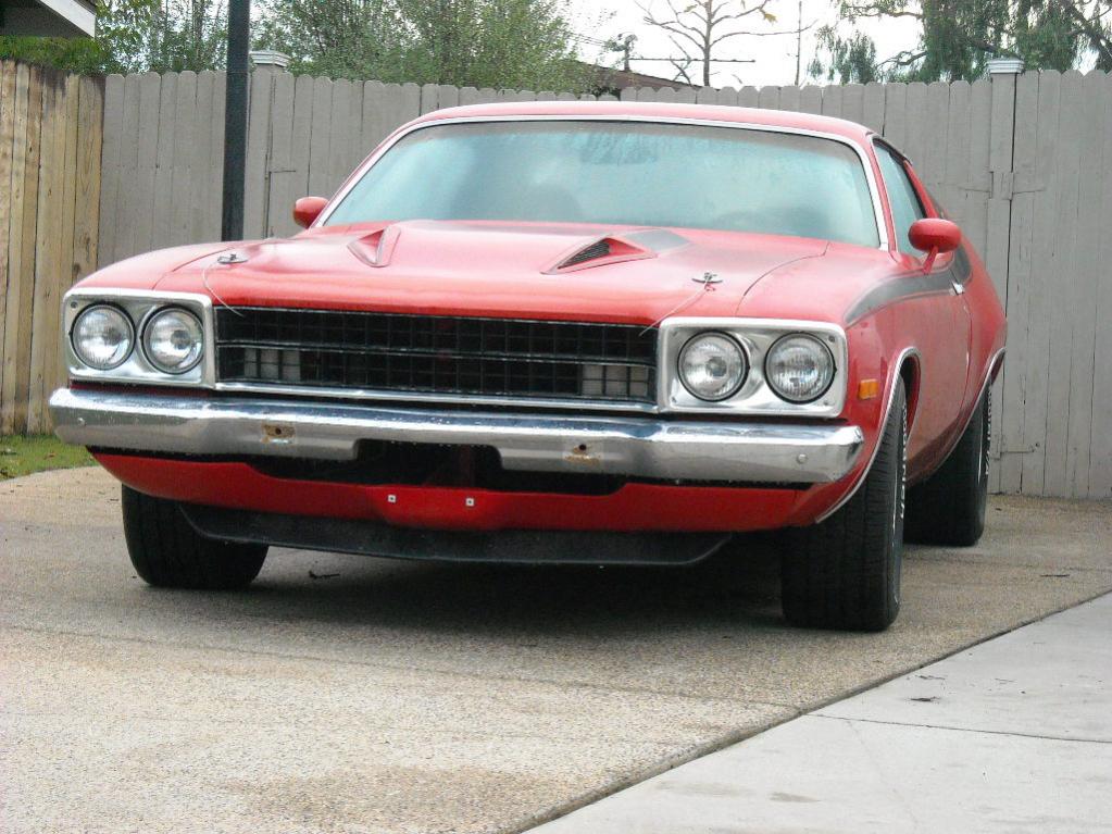

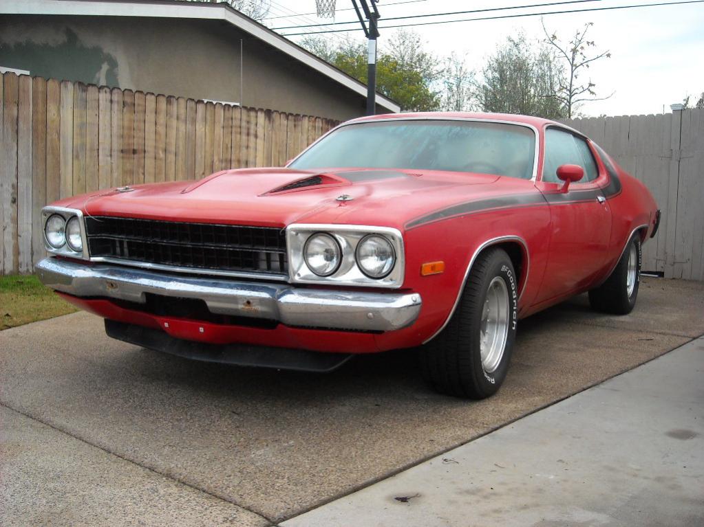

my photo gallery shows 17x8s w/ 255/55s all the way around 4.5 b.s. Yes I get some rubbing on the fender strut on bumps w/ tires turned. I'll have to route that diff. as I like the width and want to keep the same size all around. A 245 I'm sure would have avoided this but I didn't know. The tire guy said I plenty of room, he was wrong but just slightly. I'll get around it, as I said I like the look.
