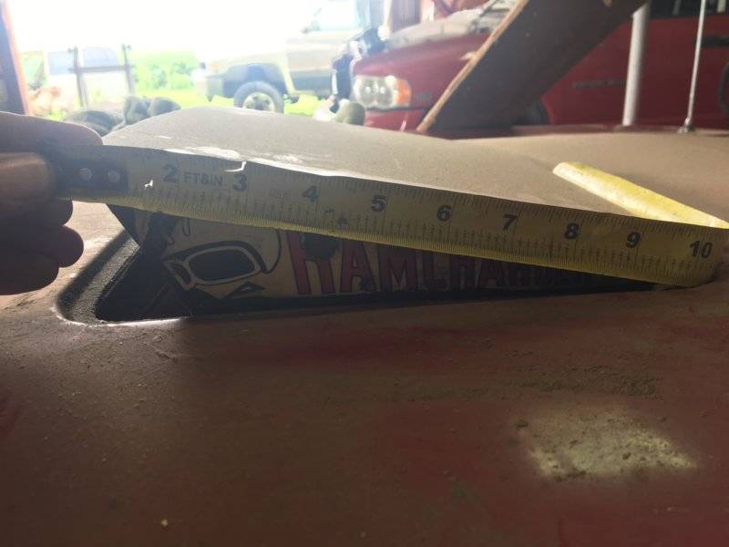

That help?
No. That's a Dodge. I'm looking for the location for a Plymouth. It has the words "Air Grabber" on the top of door but thanks for the effort.
Hmm I have always wondered what determined which decal was on the scoop door, lol now I know! Appreciate that!
The Charger had the Ram Charger decal that you posted and Plymouth had one different that was the teeth, but plymouth also had a white decal on the top of the door that read "air grabber".
