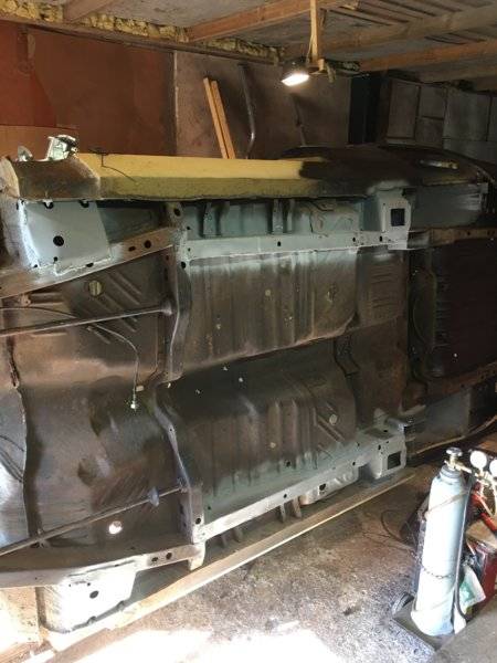

Installing US Car tool Level 3 chassis stiffening kitt on my -71 Satellite
It’s my first b body project and looking forward to get it ready.
Minitubbing, spring relocations, torque boxes and subframes already connected. Next will be Inner fender braces weldings.

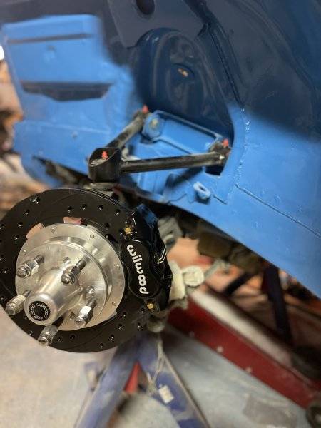

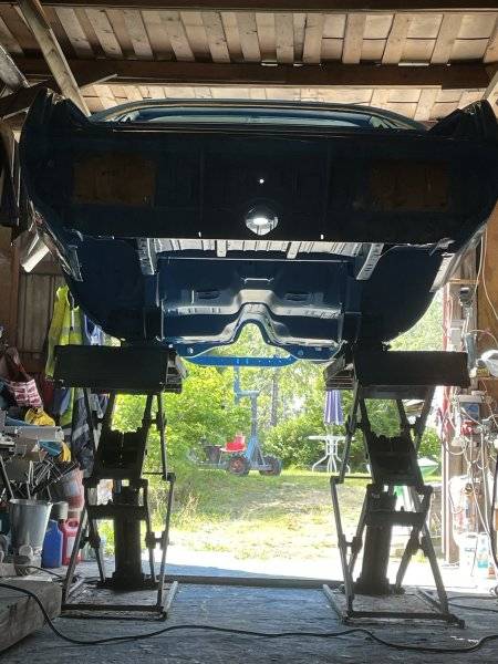

Good day Gents
Thank you for your comments. Added underneath pics.
Need to check out what fits my engine bay layout best.
Elephant ears is one option as well. I assume it will stiff well front subframe.

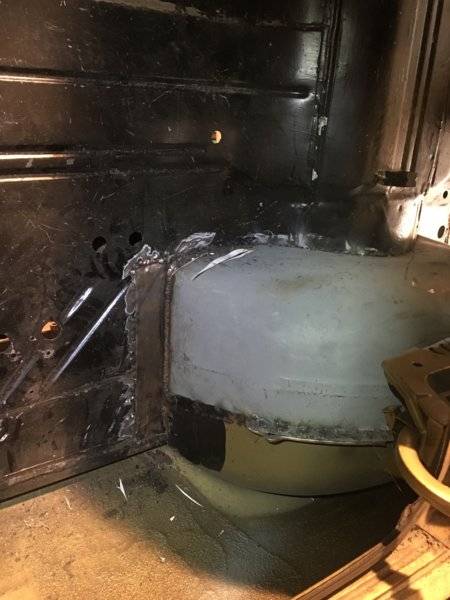

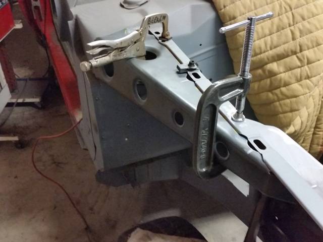

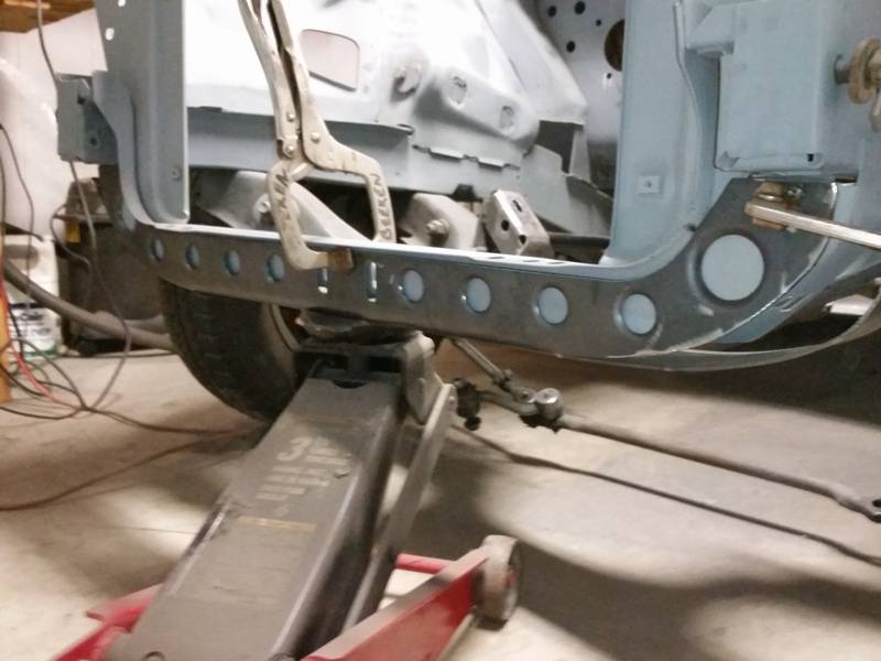

Mrluoto - I put the US cartool inner fender braces on my 71 Clonerunner along with the rad support brace.
US cartool at the time only offered the inner braces for E-bodies & not B-bodies.
I phoned them and asked if the E-body ones would work on a B-body and they wouldn't give me a straight answer.
So I ordered them anyway.
Long story short is they will need some massaging but its not a difficult task.

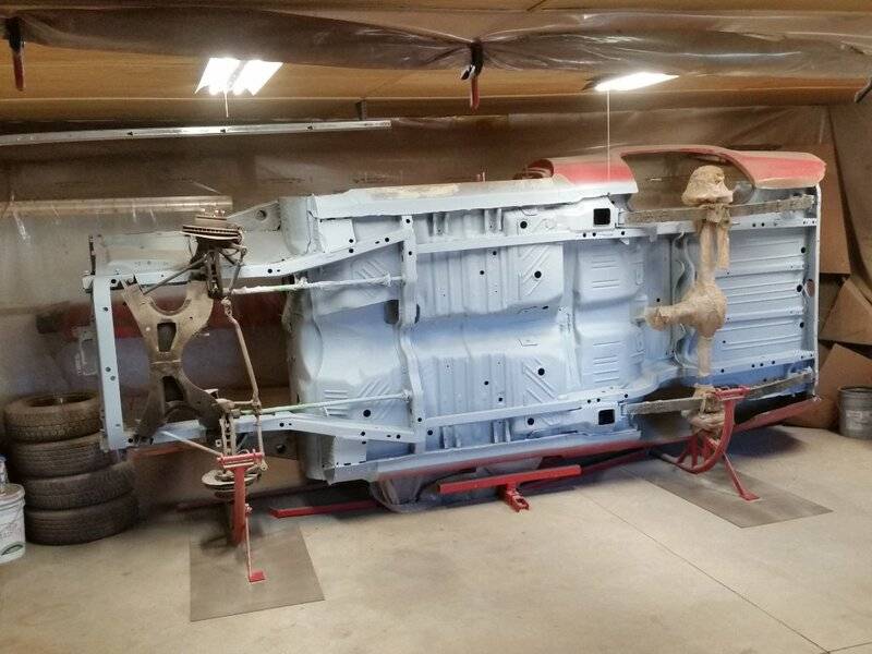

My car also has front and rear torque boxes and the frame connectors too.
But it is a street car.

Wonderful build Mrluoto,
I am a fellow 71 Plymouth owner in the UK.
I was going to go the same route as you with all the body mods, but as she is a numbers matching GTX I kept her fairly original.
Just some home made frame connectors and lots of rust replacement lol...

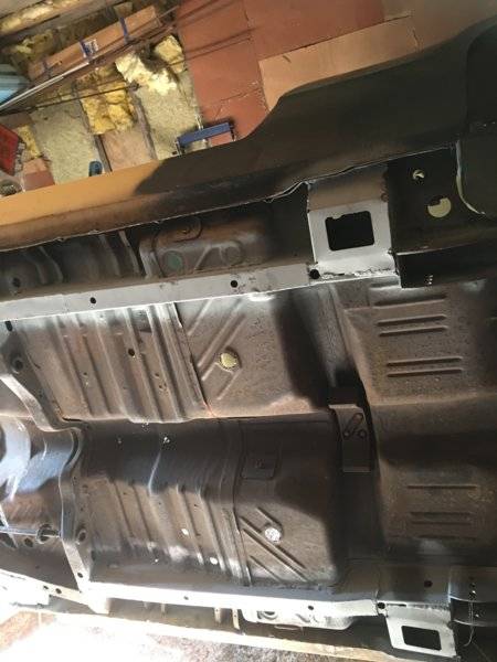

Those look like factory GTX strengthening plates and torque boxes?
Have you fitted them yourself or did your car come with them?
Obviously its a lengthened E-body floorpan for the 71 B-body...(hope thats right)?

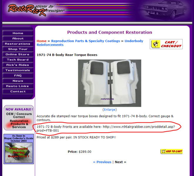

Yes, I fitted the front and rear torque boxes.
I got them from here.
I do believe that the front floor pans are the same as E-body, not sure about the rear pans.

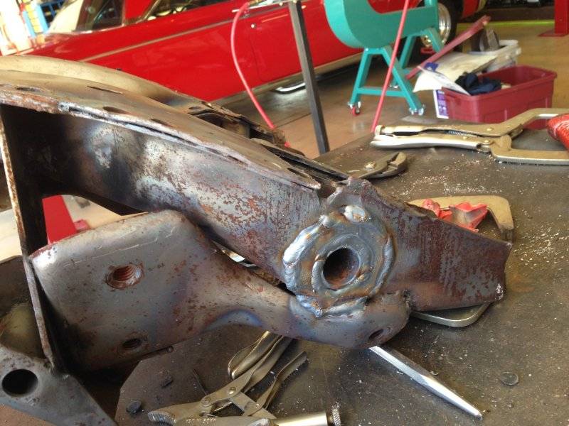

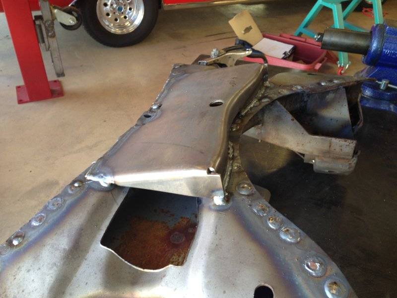

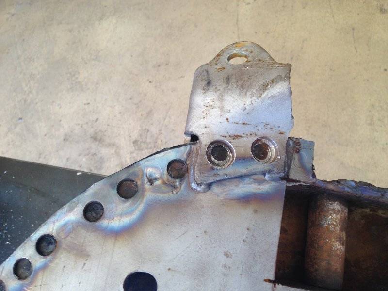

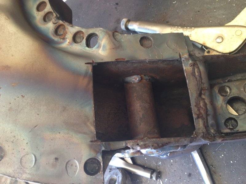

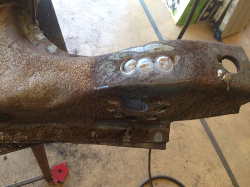

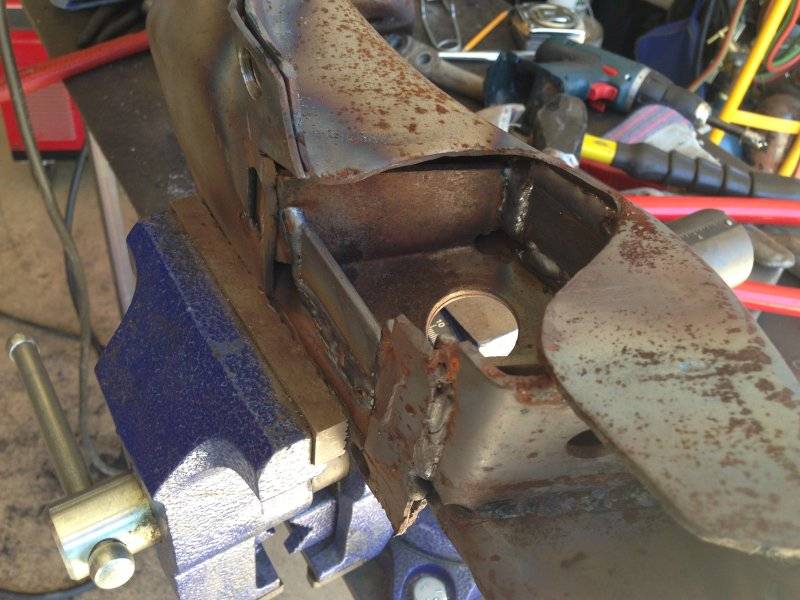

Try what I did on the 70 k thats for my 65. Using my RotaBroach set, I put in 120+ holes in the frame to add more welds to the k. I only went through one layer with the exception of the idler arm mount where I went through two. Factory was only 30 or so. Added gusseting to the strut bar pockets, cut windows to expose the lower a-arm shaft tubes, welded those where accessible, added reinforcements at both ends of the tubes, skid plate. I still need to work on the topside to cut away some excess material, add gussets to the steering box mount and some other areas. Other than the broach set, very low budget improvements. Adding the extra welds in cuts down on the flexing. I did these mods as I plan on doing track events, autocross, some drags and plenty of twisty fun.

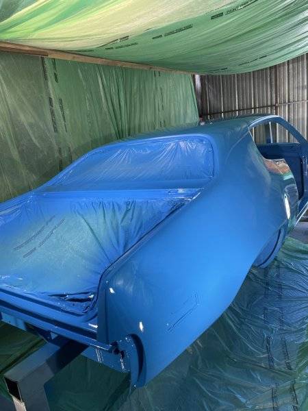

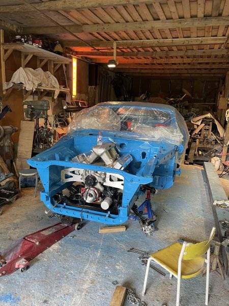

Paint work pics. It’s my first mopar and my first paint job.
Painters just asked too much money for paint works. It’s my project and my learning curve. Learning by doing!

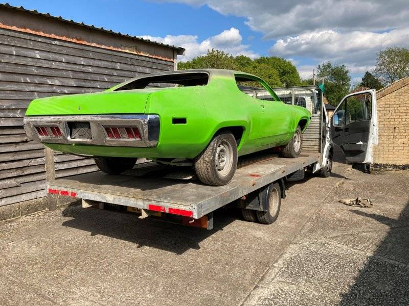

Then we can have a race to see which 71 is the best in Euro Super-stock lol?
