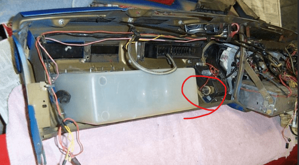

Both the 4 way flasher and the turn signal flasher are located above and to the right of the ash tray.
If you can get your head under the dash in that area you should be able to see the flashers.
You can see one of the flashers in this photo circled in red.
