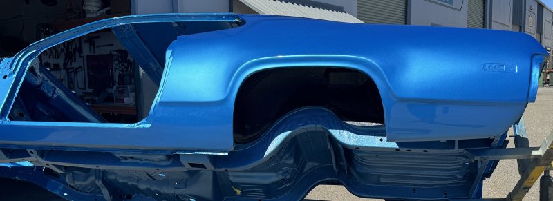

Fresh from the blaster
Man, that looks good. Are those aftermarket stiffeners?
HemiB did you have to do any metal repairs before you blasted it? Looks great!

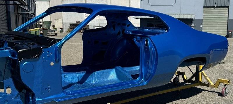

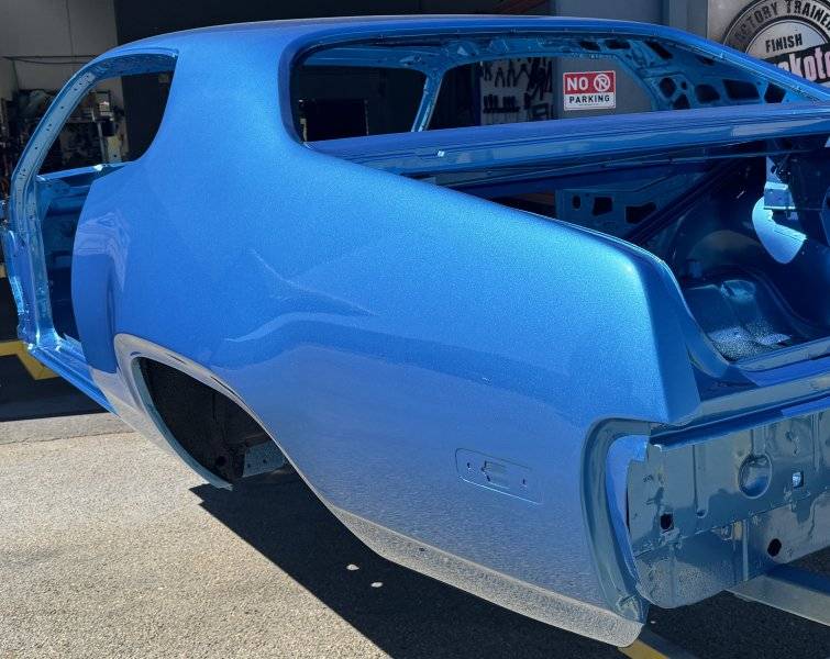

small lower rear quarter rust repair couple of small holes around back window
Was stripped in 1989 to make into a drag car then left in Nevada until last december bought with no drive train using a new 6.4 srt with 8 speed 8 hp70

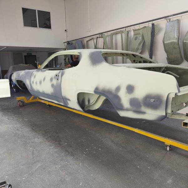

Waiting waiting on paint New SRT Frostbite blue still plenty to do .

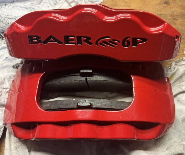

Getting the brakes ready first time at power coating all in the prep, bit thick on the front but OK Baer 6 piston 14" pro front ,4 piston wilwood rear 8 3/4 355 with Torsion tru trac.
Not big on the Baer rears as they have Aluminium hat's rather than steel also the Wilwood has a better emergency brake setup.

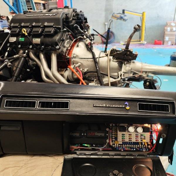

Working on the dash always looking for somewhere to put my phone so why not on the dash does all the music ,GPS & charges ,Holley 12.3 ,USB outlet for datalogging still might move some stuff around also i dont use the glovebox so i put the Holley Terminator XMAX & Fuse relay panel for easy access,Digital Vintage air controller

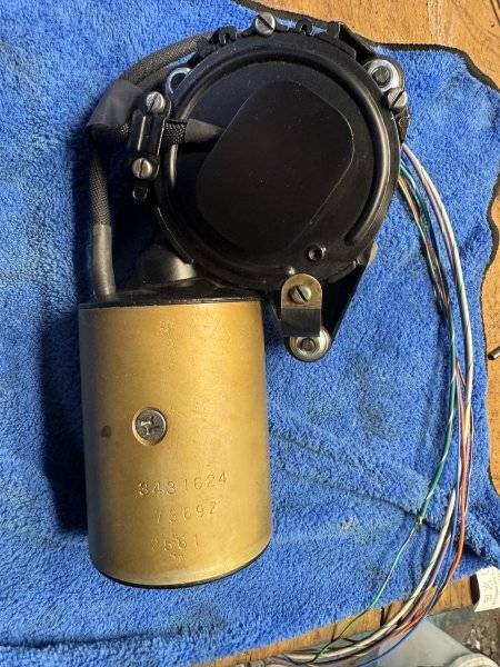

Rewire & sleeved wiring on Wiper motor milled a cap for the park wiring

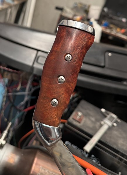

Made up torque mount using a couple of old lower control arms also cut the quick shifter handle & milled over lapping joint's not sure what the quick silver is made from but you cannot weld it used lace sheoak for the handles ,Fitted turbo blanket to Borgenson box for a bit of heat shielding
That's a nice looking dash!
Is that a kit or did you fab it?
Had to make it from scratch after a few attempts at making an insert with fibreglass I ended up welding a long piece of sheet metal in then mounting a sheet of carbon fibre from the rear
