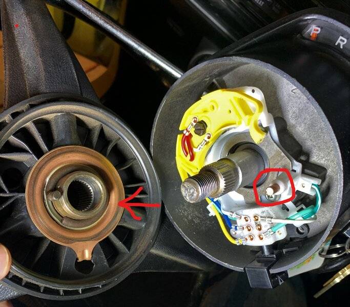

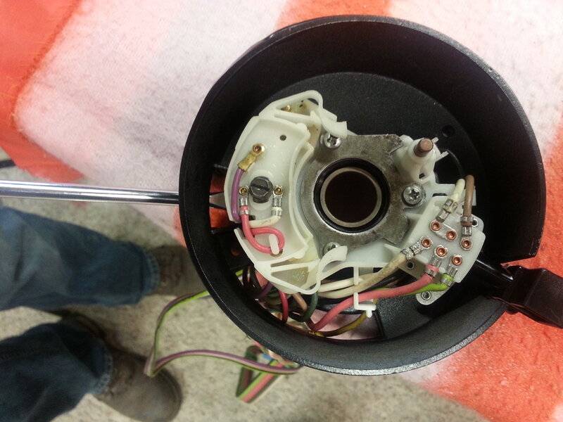

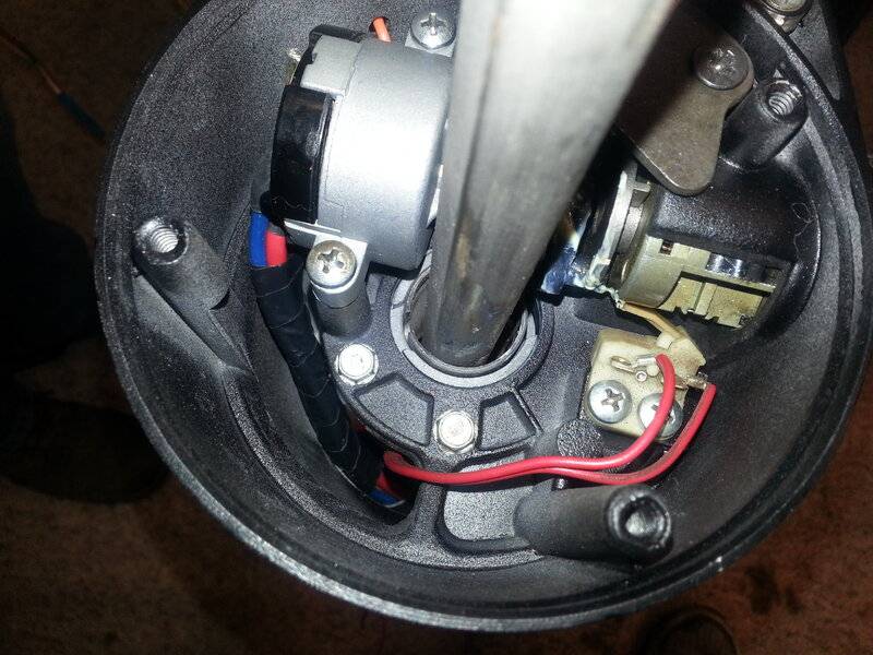

Hello all:
Anyone have a picture of how the center horn is hooked up inside the column to make the horn work? I know the column is grounded to the dash but I can't remember where the center of the steering wheel ground gets hooked to. I think it's to the screw in the upper right of the picture(?) if my pictures are coordinated right when I up-loaded them.
Thanks!
Mine is grounded with the pin in your picture at about the 2 o'clock position. The back of the steering wheel rides against it.
If I have this picture rotated right, the #1 or #2 position? Thanks
I got it. THANKS!!

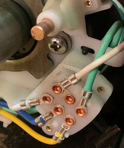

The type of switch you have there, regarding the pin that rides on the back of the steering wheel. It will eventually get noisy and start shedding metal filings. See pics below of mine that did that. The originals had a small wheel on the pin that rolled on the back of the steering wheel. I ended up having to source an NOS switch.
Warning....
