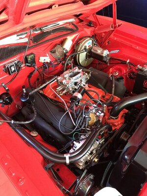

Can/should this line go to the back of the carb (Edelbrock 1406) on the 3/8 orifice like done originally or, leave capped off? Just did all the lines for the vapor separator in the left rear wheel house to the fuel tank. I think so I just want to be sure. FSM doesnt give an exact pic unless I overlooked it. Thanks in advance

Can/should this line go to the back of the carb (Edelbrock 1406) on the 3/8 orifice like done originally or, leave capped off? Just did all the lines for the vapor separator in the left rear wheel house to the fuel tank. I think so I just want to be sure. FSM doesnt give an exact pic unless I overlooked it. Thanks in advance View attachment 1147745
The three nipple breather was, in1970, standard on California vehicles only, and, in 1971, standard on all 50 states application. The large hose connection to the air cleaner was to provide an air intake source for PCV system. The small hose connection was FROM the fuel vapor seperator located near the fuel tank and the middle or medium sized nipple was connected TO the carb's fuel bowl vent. The whole system used the ENGINE'S CRANKCASE as a storage place for all fuel vapors, to be purged, when the engine was started, thru the PCV system. During WOT conditions, when manifold vacuum is zero, the engine's blow by and any fuel vapors were directed to the air cleaner via the large hose connected filter housing. Later, this system was abandoned in favor of a charcoal canister with on demand purge, similar to the system GM used....far more effective and eliminated the possibility of a crankcase explosion. All this is explained in the 1971 FSM for the intended vehicle. Just my opinion of course.

Much obliged on the breakdown, thank you! I will have it hooked up proper this evening

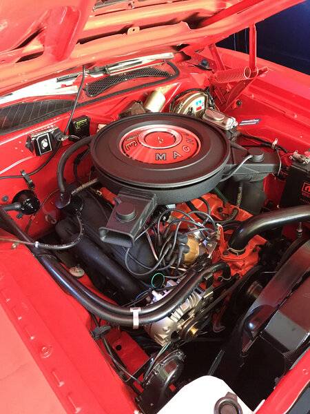

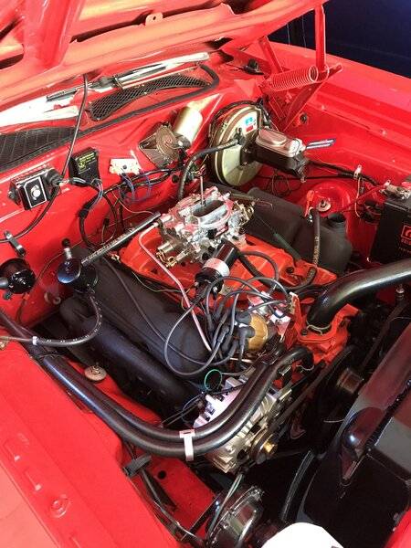

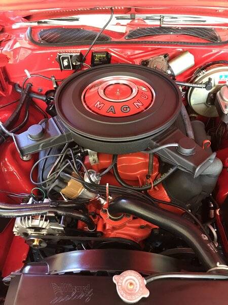

The factory 1971 Carter AVS had a bowl vent nipple for that hose off the three nipple breather
Your Edelbrock Carb does not have this float bowl nipple - The Edelbrock vents thru the holes on top of the carb
You can see how the hose off the breather really goes to nothing - It just vents open to atmosphere
There is nothing to hook it to , so I leave it open and the hose looks factory and is hidden by the factory air cleaner
