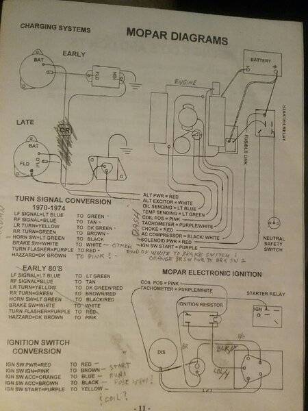

I'm trying to figure out the igniton.wiring making use of the 21 circuit ez wiring pack. Spent 5 hrs on it trying to figure out why I'm getting no spark.
Everything is new.
Using a proform electronic ignition pack with the 4 pin ecu
First question.is I'm only getting 12v when trying to start the car, crank mode.
The ez wiring has a pink coil wire thst gives that 12v only when trying to start the car.
There's a purple wire that goes to the starter solenoid that gives a pulsing voltage which I assume I.should feed off as well? Or does the coil need constant power even in the on position? Should I be feeding off thr alternator? There's no other wires that goes into the firewall from the bulkhead.
Thx for the help
Herea the wiring diagram I found online for the pack im using
That diagram is using 5 pin ecu. I have a 71 Charger 383 car. I have a repro electronic ignition engine harness from Evans Wiring and mine will only run with a 4 pin ecu. Wont ev3n start with a 5 pin. Maybe a 5 pin ecu is what you need, give it a try. Just a suggestion. Could be that simple

For anyone using ez wiring the white alt excitor wiring can be used for the crank position. ez wiring told me to tie together ign 1 and ign 2 but I think thats if you dont use a ballast resistor.
ill let you know if the HEI setup works.
The EZ kit should have a wire marked "coil" that should be hot when the key is in run. If you have a mechanical fuel pump, you could probably use the fuel pump wire to power the ignition if the coil wire isn't doing what it's supposed to do.
I needed a wire in crank position I get them mixed up. I looked at the back of the bulk head and the crank wire feeds the alt excitor wire as well. I'm going to try once more with this procomp kit. But the module might be defective. For the fun of it I tried to check the voltage coming out of the coil and only got 6v to 8v. Lol. I didn't care if the multimeter smoked I was getting frustrated. This is my second accel coil. Unless the multimeter isn't able to read that high of a voltage.
