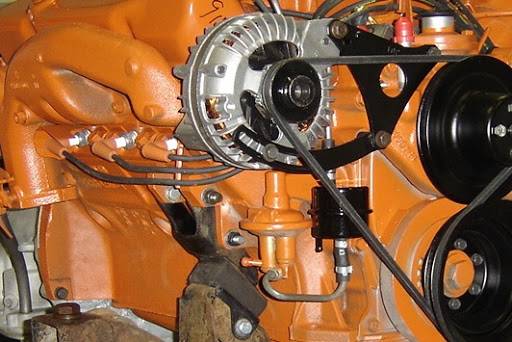

just right down the alternator
wLL9C3XHiZ0UlF29_ZM8-KA_zS7YrhbS1iPRrr8awgqe02Wh0Dl4NxYWV5iaS6EkYXbdr8q5BFyoPC9xrDYiZ9azy43g5b5h.jpg

I just posted the only pic on my web search able to show the exact location.

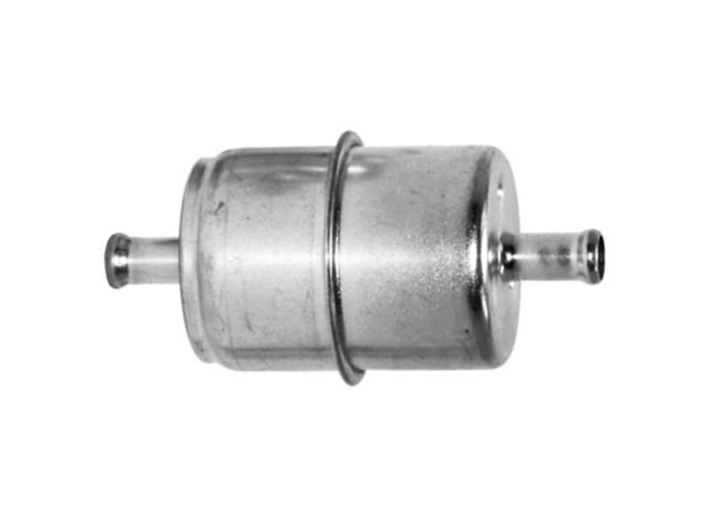

I have a 3/8 fuel filter

Small Steel Line Will Come Off Your 440 Flared Outlet Fuel Pump - Then Other End For Rubber Hose To Fuel Filter / Fuel Strainer Like In That Nacho Picture
Larger Steel Line Is Designed For Factory Carter AVS Or Edelbrock Carb With Flared Inlet
Other End For Rubber Hose Off Fuel Filter / Fuel Strainer

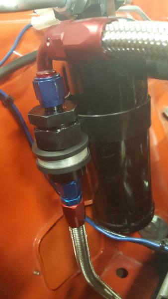

I know it is not correct but here is mine, mounted right next to the A/C drier. Reason being mainly because there is so much stuff going on between pump. belts, alternator, and hoses, I decided to relocate it so I can clean it out.
