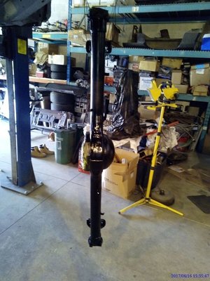

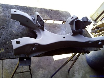

    OK a grinder worked well I put a relief cut then hammered it with a chisel finally came off. One bearing was toast and one was good but replacing both.
    Cleaned up the housing and reinforced my k frame with firm feel brackets.

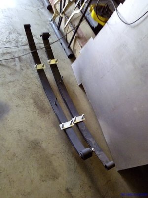

    Rewelded all seams as well . can anyone let me know if the Mopar leafs should have clamps on each side or two on one side the leafs didn't have clamps I guess they fell off. I cleaned them up but unsure of clamp position they are from a 71 superbee 383
