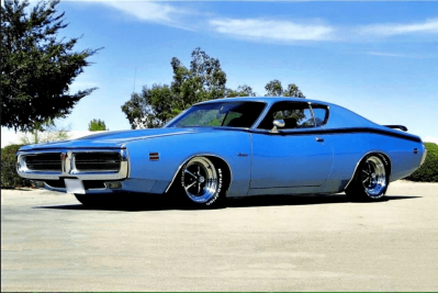

i am rebuilding my current leaf springs and wondering if i should go new
i want to lower my car to something like in the picture
will the ride be horrible?
does that look like 27" wide tire in rear?
would i be able to use lowering blocks 2.5" lowered leaf springs new?
i dont know at what point itll be like im driving on a concrete block with no suspension
That car in the picture has to have air bags, your guess is as good as anyone else's on the tire size from that picture.
ah ok. if i did a 2 1/2 drop would i need the different drop spindles?
Consider lowering the car will create an issue with you axial 3rd member hitting the lower pan. Typically an axial snubber helps but your springs will be weak resulting in more movement. Recommend air bags for car show when parked. on the road, maintain enough height to control your chassis ride.
I mocked up 2.5" drop spindles and 1" de-arched rear springs and they do not look nearly that low, so I agree that it probably has airbags. If you assume those are 15" wheels, you can guesstimate the height of the wheel opening. You will have geometry issues if you go lower than the 2.5" drop spindles with the stock torsion bars, and I believe there is already some stipulation attached to some of them. I do not recall what though, as I ignored it :)
