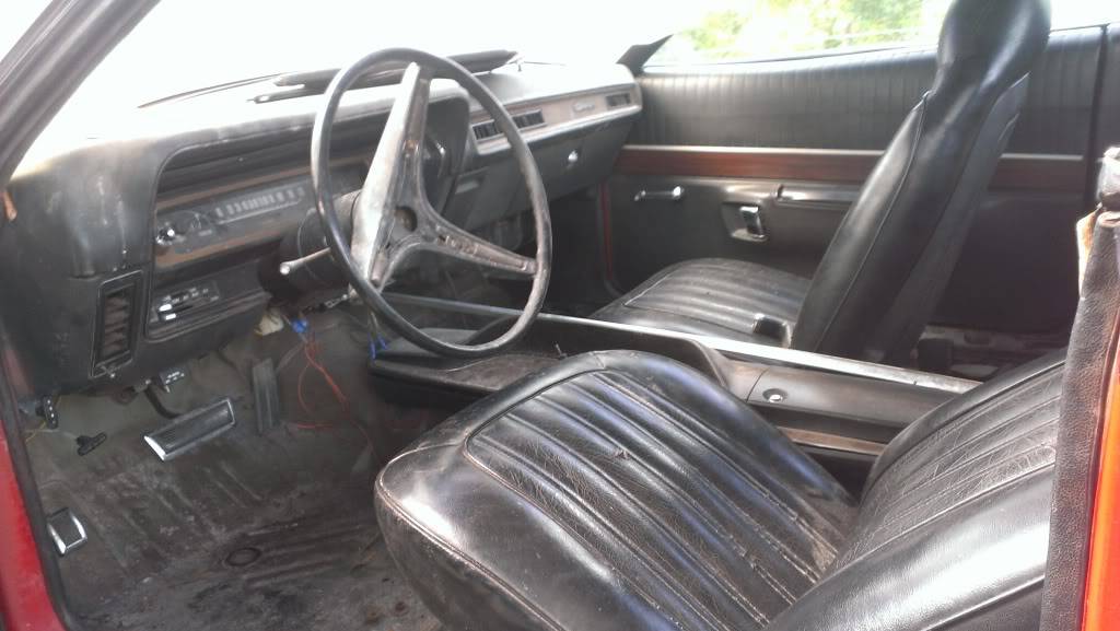

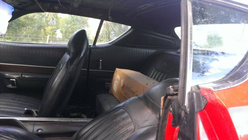

I have a chance to purchase a 1971 charger with a slightly worked 318.. I believe its an SE because it has bucket seats and center console and hidden lights. The carpet is out, and so is the headliner, but the guy will sell it with a new carpet in the box. The interior otherwise is dirty but not seemingly flawed. The vinyl roof is gone and ready for paint it seemed. And the body is straight although upon knocking found a few spots of bondo. The bumpers look faded but not pitted, just needs new chrome. has hidden lights but needs a new wiring harness, and he jumped the motor for them and they do work. Trans has a leak and he says he is not sure if thats why its been slipping but im guessing the worst. It ran really smooth and the VIN is WH23G1G......
He is asking 3400 im not sure if that's a great steal or just what they worth. Any help is greatly appreciated.
Why is he selling it, and what condition would you hope to get it in before finding it acceptable to drive? Are all the headliner bows present and marked for the correct sequence? Working air conditioning? Not many pictures to go by, but aside from some potentially scary wiring and steering wheel, it could clean up.
Thing is, what are your skills? How much of the needed work can you do? Have you checked for rusted frame rails or rot around the rear window? When you say things like "just needs new chrome", you're looking at $400 or more for each end, if they're not dented. If you can handle the work, I've seen a lot worse starts right here on this forum...

Looks like a base Charger with the concealed headlamp, bucket seats, and console options. Upper door panels on an SE are unique. A 500 should have R/T taillights and a rallye dash. The Coupe has fixed rear side windows.

I concur that it's not an SE and probably not a 500, but it does look fairly solid and has some cool options with a decent color combo.
Welcome to the site and great to see another central FL Mopar guy. That car looks to be in good shape for what it is, and the price is a good one for what looks to be there. Since he's asking $3,400, I'm guessing he's looking to actually sell at $3,000, so I would say you're concerned about the bumpers and the tranny, which will cost you about $1,400 to replace, and offer him $2,800 and settle on $3,000.
Replacing the headliner is pretty easy because of the plastic sail panels.

It's not an SE, I have one, an SE VIN would start with "WP29". Hidden headlights fit any of the Charger line, so they were added by a previous owner. For the record bucket seats/console don't mean a thing, my SE has a bench with a fold down armrest. Do you have any pics of the front of the car?
As far as the price it's a little high, but I'm cheap, $2800 or a little less due to the transmission issues.
