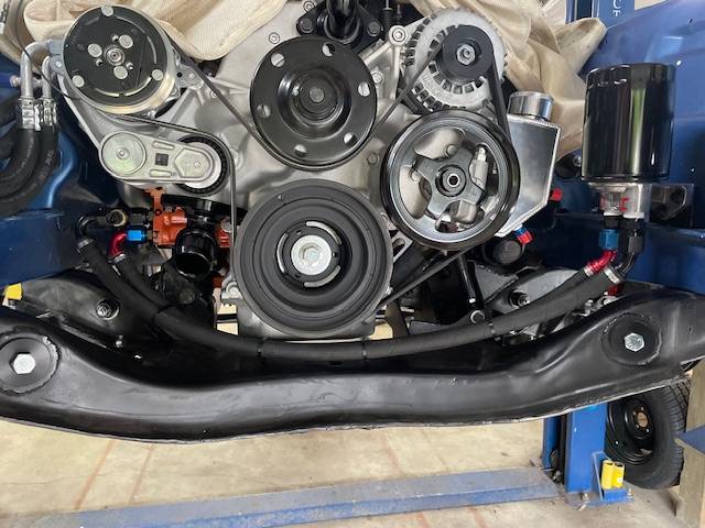

I was able to get the remote oil lines finished up today.

yea I thought about that but I've worked on several vehicles that had the filter mounted this way and none of them were overly messy. The key is to let it sit for awhile I think but it is what it is I guess, if it becomes and issue I will change it.Looks good, but changing the filter will be a mess.

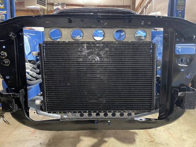

Thank you very much, took a long time to make (like everything it seems). I still don't have the bottom attached to the core support but will get that done tomorrow. There will be 1/8 neoprene between the mounting plates and the condenser, not sure if it needs it but I figure it cannot hurt, I did the same with my radiator.Those look awesome!
