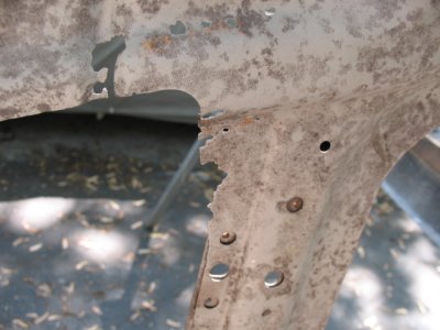

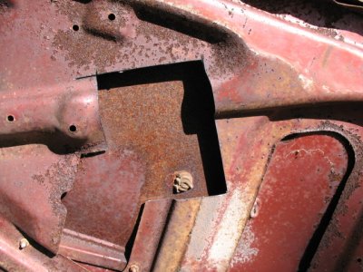

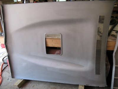

Me and a couple of buds are finishing up a resto on a very kool and real `71 Charger R/T that is an orginal N96 painted bumper car. The car was about 75% finished when we took it over and did not come with a fresh air hood. We ended up finding one locally that was rusty but complete for a not suprisingly large chunk of change but these things are rare and we really wanted to put the car back to original so we bought it. Took it straight to the media blaster and unfortunately didn't get any before pics but it looked rough and it got worse after it was stripped.

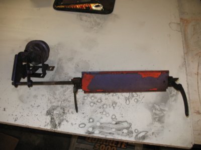

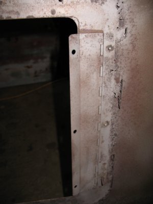

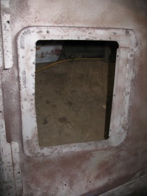

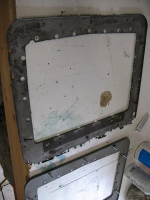

There was no saving this ring that the airbox mounts to so I hand fabbed a new one only to find out that it's repopped, didn't think it was, or at least not oem style. I will say that building one from scratch was a heck of a lot cheaper then the repop and it was fun to build too.

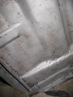

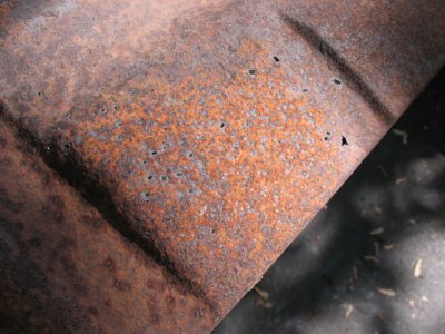

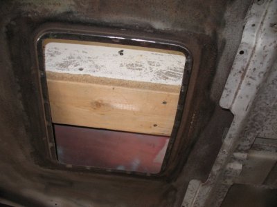

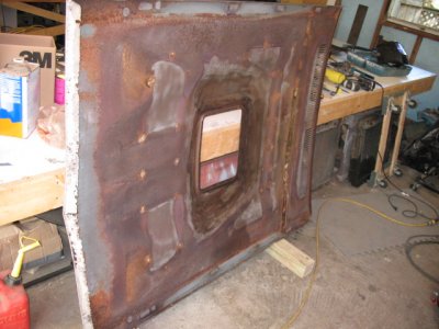

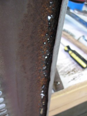

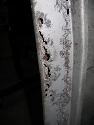

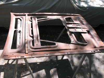

I decided that even after being stripped that there was still a lot of rust in between the skin and the understructure that I couldn't leave in good conscience, especially on such a rare high dollar part. The only way to get at it was to seperate the structure from the skin. This will also make the individual repairs needed on this piece easier to perform and the hood will last forever for the next owner. The words I live by are "If something is worth doing, it's worth doing right."
It came apart easily as there were only 26 spot welds and the old dry adhesive that was used to bond the skin to the frame wasn't doing much anymore. There was some very deep pitting hiding in between that would have eventually come back to haunt this piece.

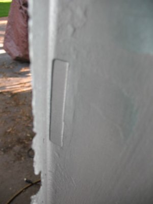

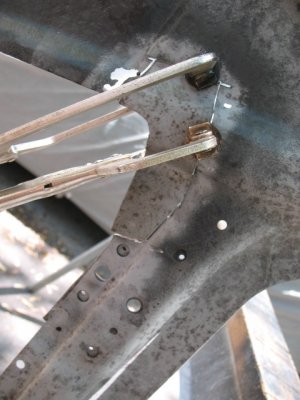

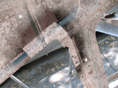

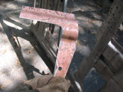

There was one spot on the frame that I wanted to replace with a graft from a different junk hood. It was the mounting point for some of the N96 hardware and I knew that it was too bad for filler. this would have been much more difficult to repair with the hood still in one piece. There was no spot on the Doner hood that matched identically so I used a section that was close and made some mods to it, I think it turned out well and sure beats the paper thin swiss cheese that was there.

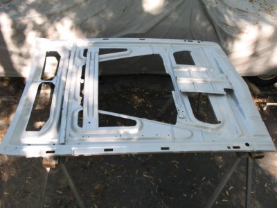

After that repair and a couple of other welding repairs to the frame I wire brushed the entire thing and put 2 coats of Rust Bullet top and bottom. Also 2 coats on the underside of the hood skin.

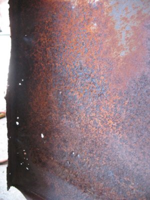

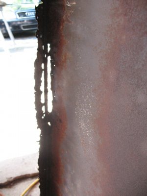

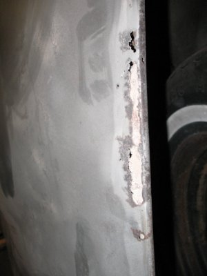

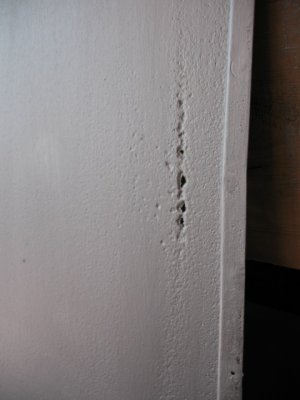

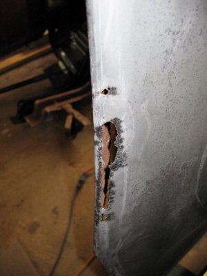

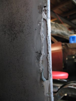

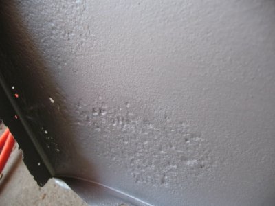

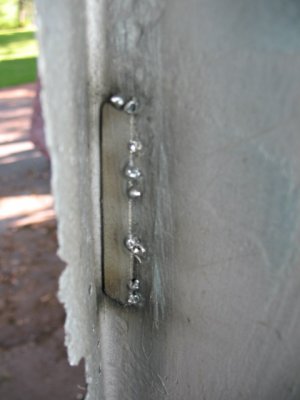

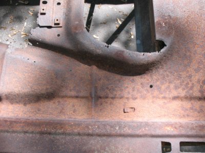

Here's the inside of the hood skin after a couple of coats of the Bullet. I didn't want to do any grafting on the skin because I don't think any of the holes are bad enough to go through that kind of hassle. The exception will be the strip that is folded under the nose and I plan on addressing that after the skin is back on the frame. The holes at the rear are backed up by the frame so the fiber reinforced filler will be fine back there. At the front the holes are a little worse so I welded in some backing plates that are covered on all sides with weld through primer.

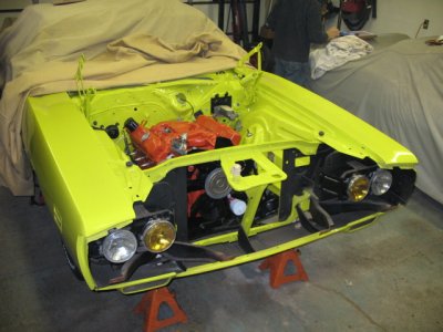

Here's a peek at the rest of the car, but just a peek.
